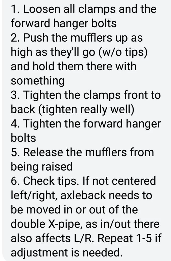

Well. I just installed a Corsa Extreme on my 2019 GT yesterday. Other than having some adjustment issues it went on pretty easy. I love it. Sounds loud when I want it to and is quiet during my long commute to work IF I stay out of it. I’ve poked through some other threads and still need help getting the tips centered up. They’re hanging a little low and inward.

What order did you tighten the clamps? I know I read a few threads where people had the same issue and it turns out they were adjusting it in the wrong order. Unfortunately I don’t remember what order that was, but searching should turn something up.

I went back to front but didn’t have any help. So it was really painful. I honestly just gave up until I can get some assistance. Still sounds great even if it is a little wonky lol

Try this procedure. It has consistently worked well. If they're in and low, then the axlebacks need to come out (rearward) of the double X-pipe slightly, and then do steps 1-5.

@CCIWDO don't worry, you won't have to modify your exhaust to get the tips sitting great in the valence.
