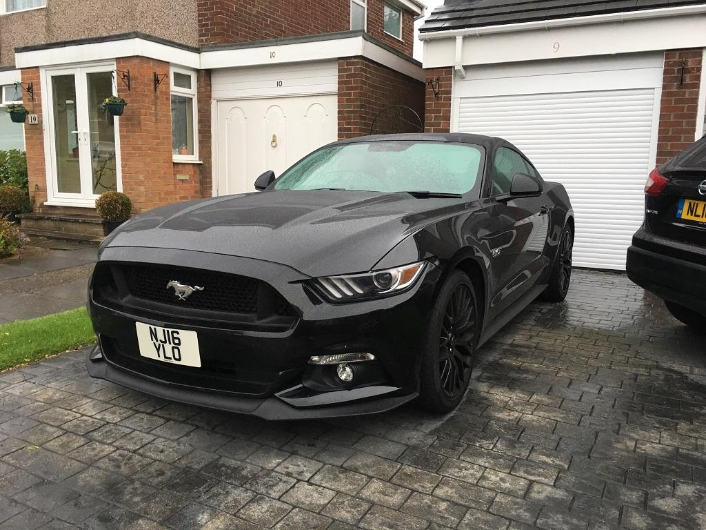

Garage phoned me at work at 4. Boss let me leave early at 4:45 to go and collect my car!
They replaced the oil cooler and got new rubber grommets for one of the connections. They've also been around the car and tightened everything up. The clutch and breaks are pin-sharp now, and its amazing, better than when it was new.
When driving home, as well as too and from the Gym this afternoon, I kept a very sharp eye on the temp readouts on the dash. The highest the cylinder heads got was 98C, but only briefly when I stuck my foot to the floor. Once you got moving on the motorway at 70 it hovered around 92~94. Before the breakdown it used to be 10 to 15C higher than that, hitting 110 without second thought. It also seems to cool down much faster when you finally sit idle, dropping to about 88, which it has never done before. Feels like it's more eager to get up and go, too, like it was very breathless at high revs and below 3k. Maybe the ECU is seeing that it's not over temperature and finally letting me tap into the rest of the power.
Either way, I'm actually alarmed at how good the service was this time. They kept me updated almost every day and the car has come back better than new. Tight as a drum.
Lookers must've gotten a staunch kick up the backside from corporate to up their game.
Well done, Ford, it's nice to have my baby back! :ford:
The coolant is a little low (just above minimum), but I'll let that slide given they threw in a free splash of petrol.
