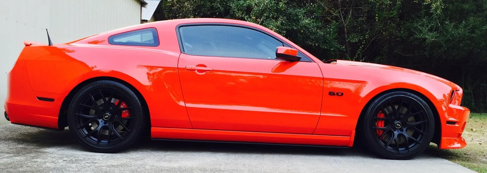

Where on your car is picture number 3?
Their response to me was, "the paint was within factory specs". Picture 3 is on the roof in the rain gutters (best way I can explain) where the door frame meets the roof, better yet, where they weld the side of the frame to the roof. Make sense?

Find the ford customer service rep on here... And for the record that is not within spec, thin exterior paint in a high visibility area is never within spec.
Yea it looks like they painted that 3rd area too heavily and the rear quarters too little
