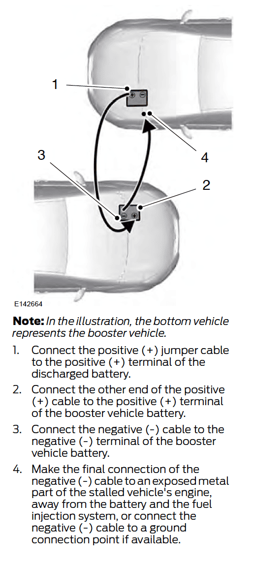

Jumped from another vehicle like I have done several times in the past. Never had an issue and it will not cause problems as you indicate (ford actually includes this in the manual). If you do not have anything to add to the thread then just don't reply. My reason for not taking it to Ford has no bearing on the information being sought. If there is a quick fix or someone here who's had the same issue then I do not need to deal with the hassle of bringing it to the dealership.
