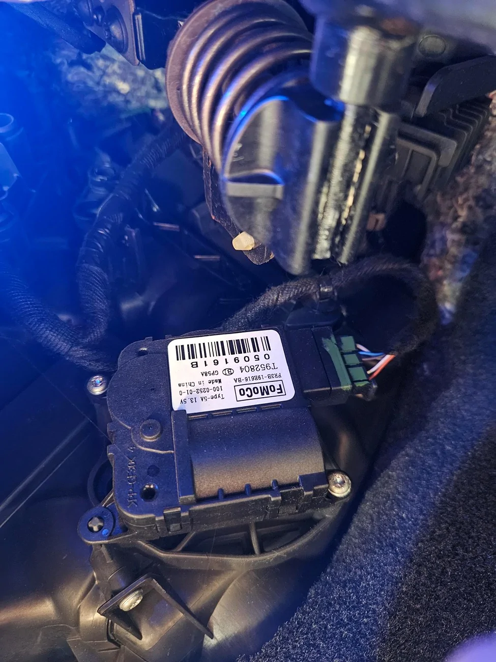

hi the clutch on mine is awful, feels terrible, and really hard to transition off in first and second without bouncing down the road, I can see in the history it had a Steeda clutch spring back in 2019 but this is supposedly better than stock god knows how awful it is without.
ive taken a pic does this look right?

The clutch spring really only helps with initial bite feel when you are getting going, it has less pressure so you can feel the grab point easier. That's the only benefit to it that I know of.
If you are having issues shifting from 1st to 2nd and experiencing weirdness there I would think you have something real going on.
Your photo doesn't show anything unusual that I can see.
