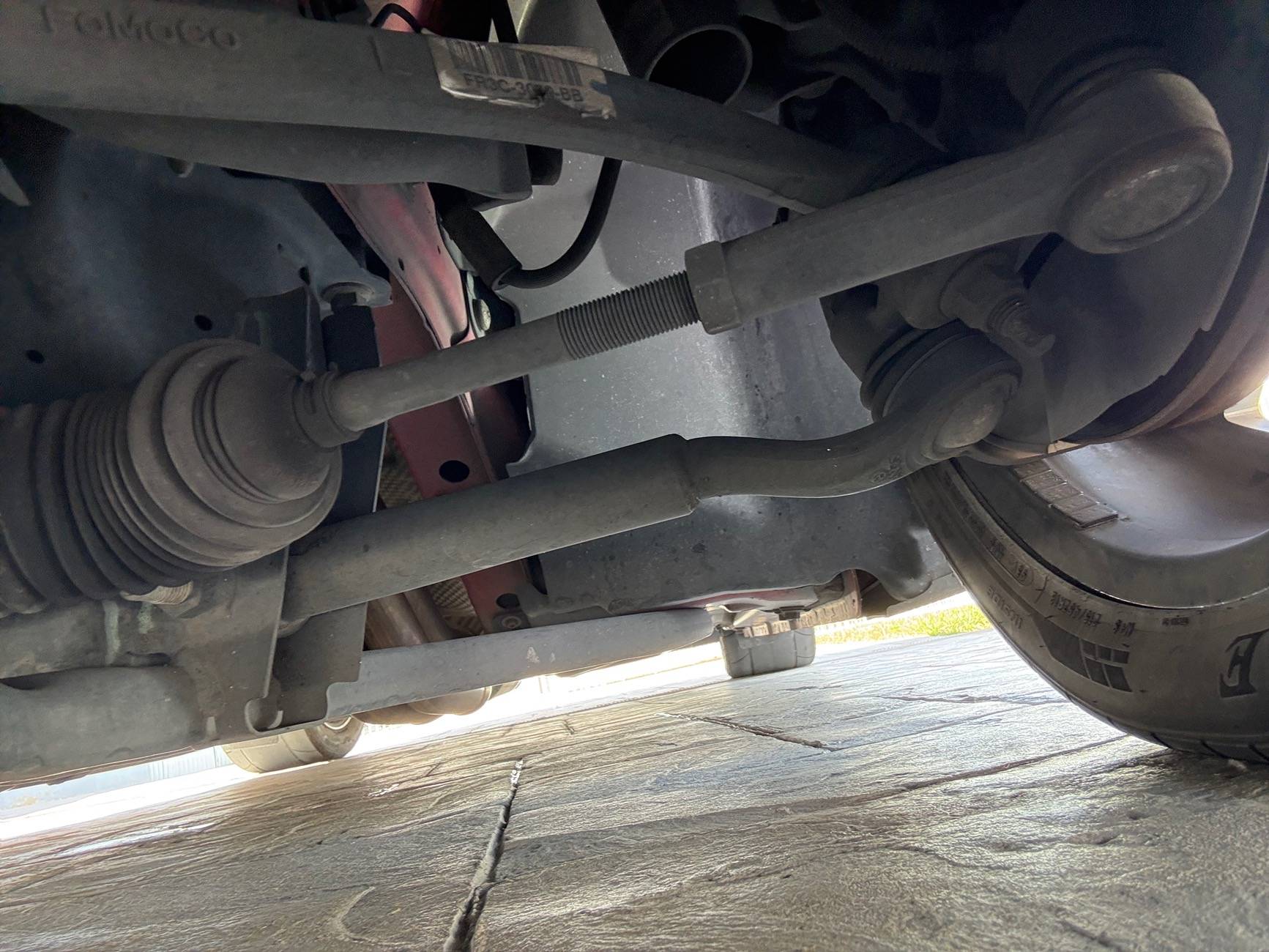

Hey guys I’m new here, looking for some advice. I got new wheels 3 weeks ago 18s skinnies up front, last weekend I notice in the drive way that when I turn my wheels left or right it makes a clunking sound from driver front end. Weird thing is that I can’t really hear it from the ourside of the car, I mainly hear it when I’m inside and move my steering wheel left or right. Any help would be great I plan on replacing my tie rods and sway bar links. Thanks

Why are you planning to replace the tierods and swaybar links? I mean, they're as good a guess as any but it sounds like you're loading the parts cannon without really any inspection or troubleshooting.
Get the car in the air and shake and pry stuff around first.
Could just as easily be a ball joint, a bushing, or even a bearing.
