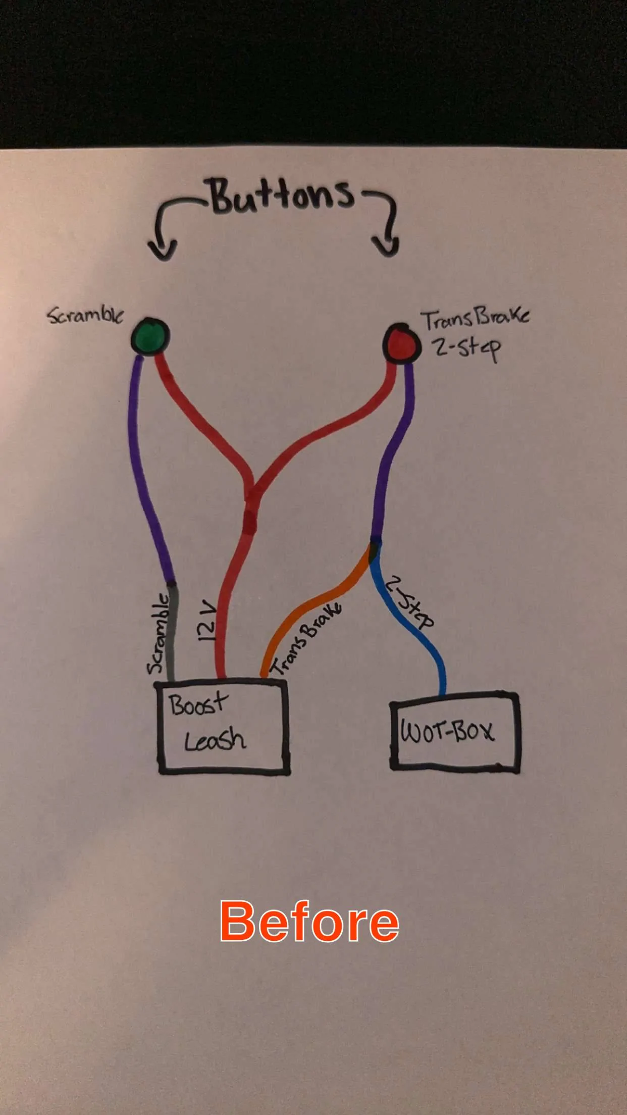

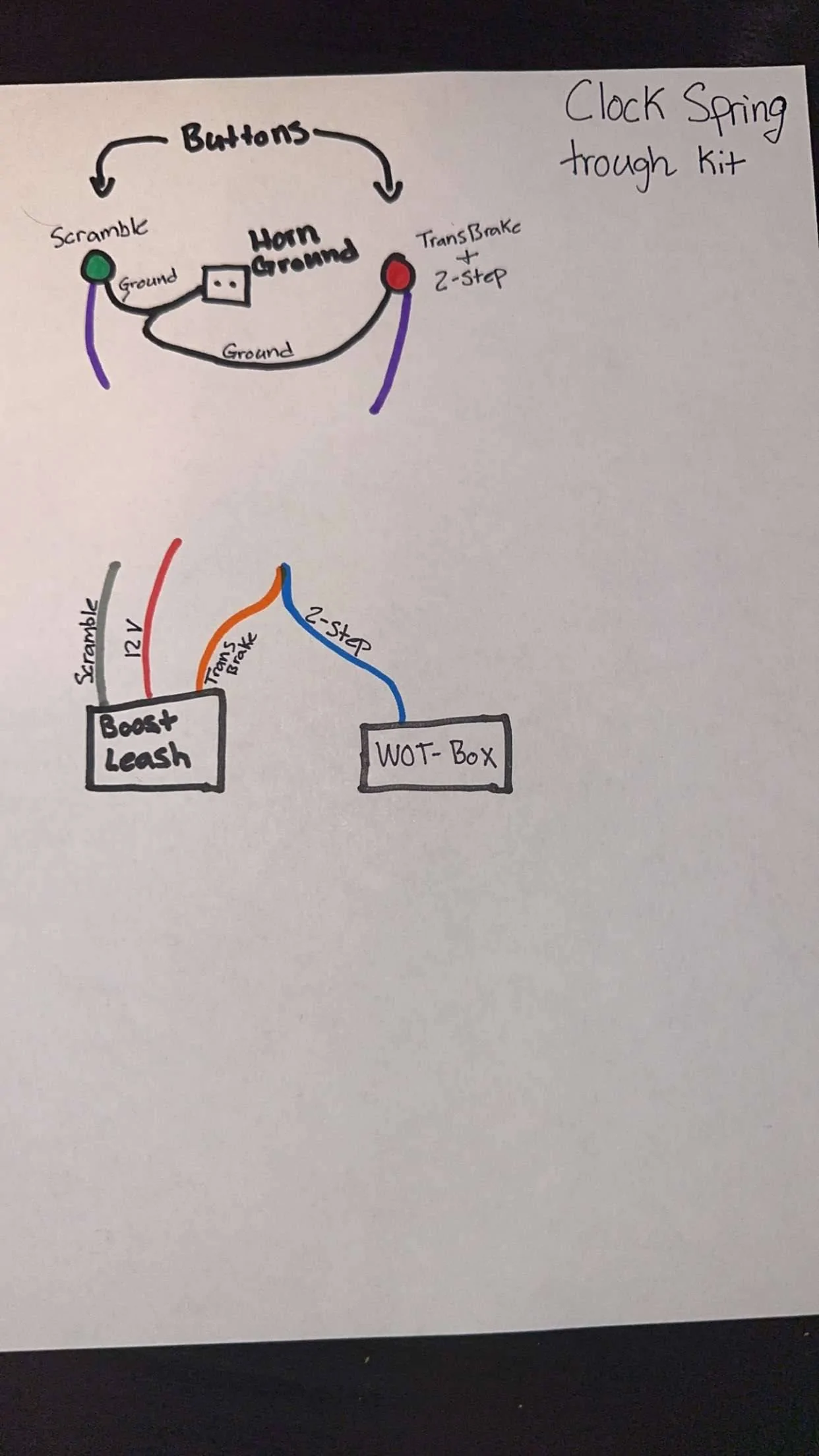

I’m in need of a little help as im trying to install the clock spring through kit, and I connected all the wires the first time and the trans-brake and scramble were always active now and I’m going to assume because of the ground and the power going to the button completing the circuit. Is there any way to overcome this issue or have any insight on doing a different way. This is the wiring diagram that I made to have a fresh start, so if anyone could guide me to complete the diagram I’d greatly appreciate it. I’m no wiring expert and I. Actually really opposed to doing wiring stuff. The second photo is the way it was originally wired with the hanging cables from the button and having it that way worked fine.

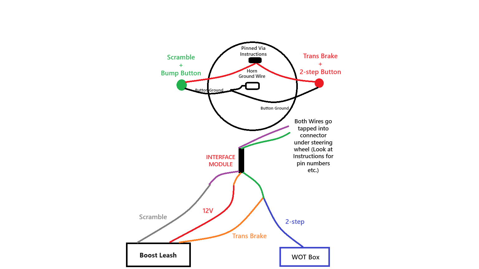

Not Sure what Boost controller you have but I drew up this diagram. It gets most of the wiring down except which pins you have to remove and place the ones that are supplied when you purchase the clock spring kit. You'd have to look at the instructions provided by them for that since I cant draw that up. If you have any further questions let me know. Sorry for the crappy diagram made it on windows paint lol.

That's a great diagram thank you so much!
But I'm not sure how those wire from the module connects to the boost controller from the steering wheel all the way to the controller without getting twisted when you turn the steering wheel?
Am I missing something or not seeing something?
From your diagram is gonna be the red & gray wires that coms out the module

That's what the (S550 Mustang 2015+ Clock Spring Pass through Kit) from thegaugemount.com

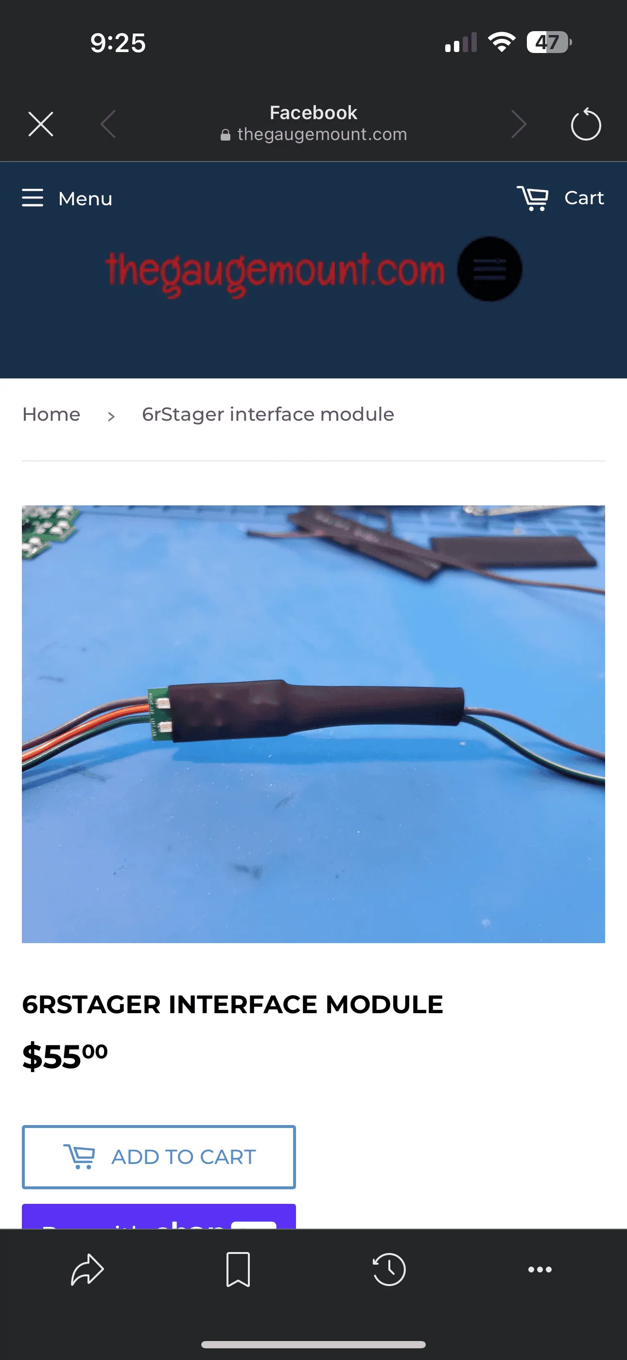

takes care of. They have good and informative instructions on how to do the pass through. To answer your question it uses pins on the connector behind the airbag which then plugs in and passes through the clock spring. Which then goes behind and under your steering wheel which is where the Interface from them as well comes into play and ties into your boost controller and Wot Box.

Within a week just make sure you order that Interface module if you need a scramble and bump button as well!
