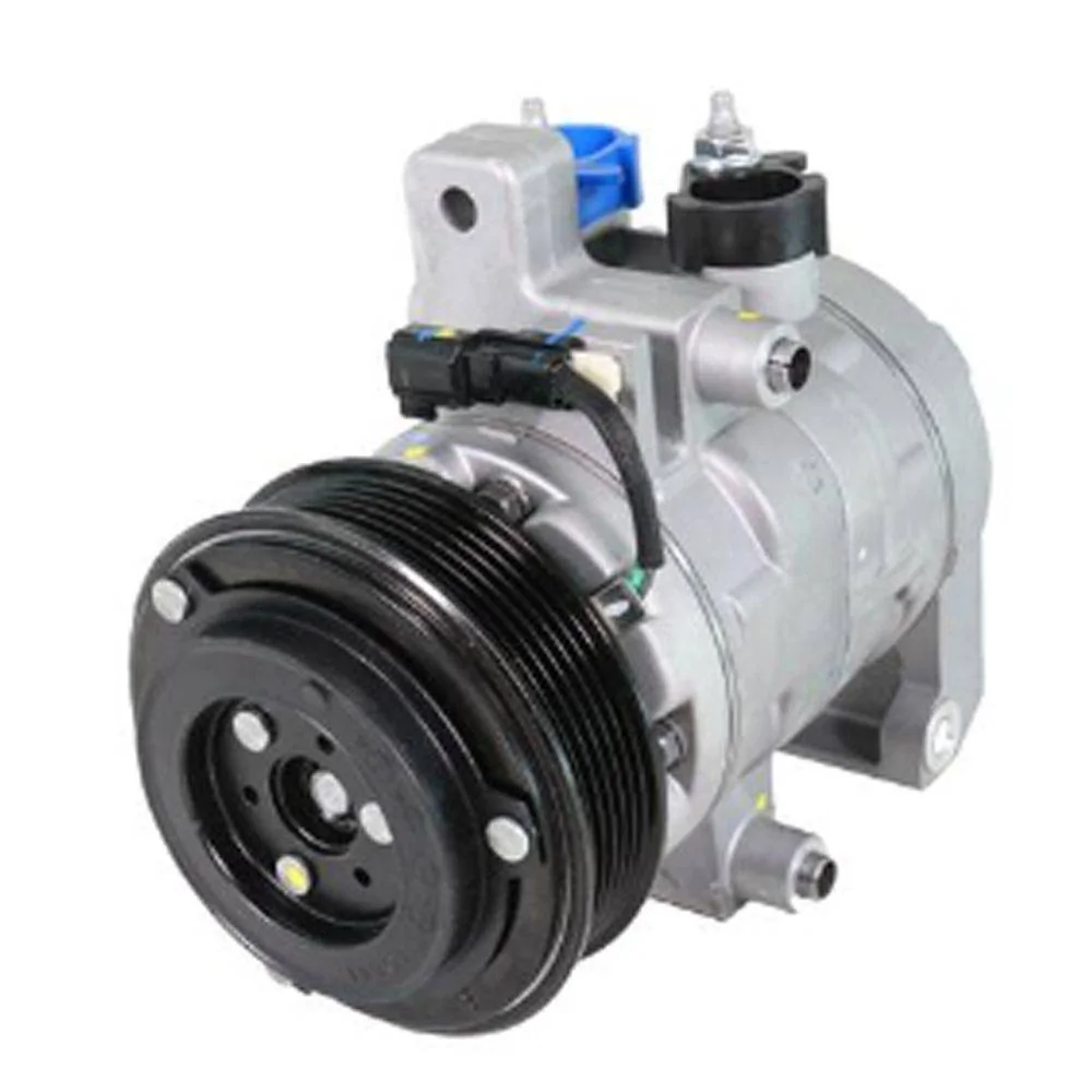

Your AC compressor should be on the lower left of the front engine, and has a dedicated belt that spins it. Is the belt spinning?
If you turn the AC on "Max" cool, do you see the center part of the compressor spin or it is stationary?
