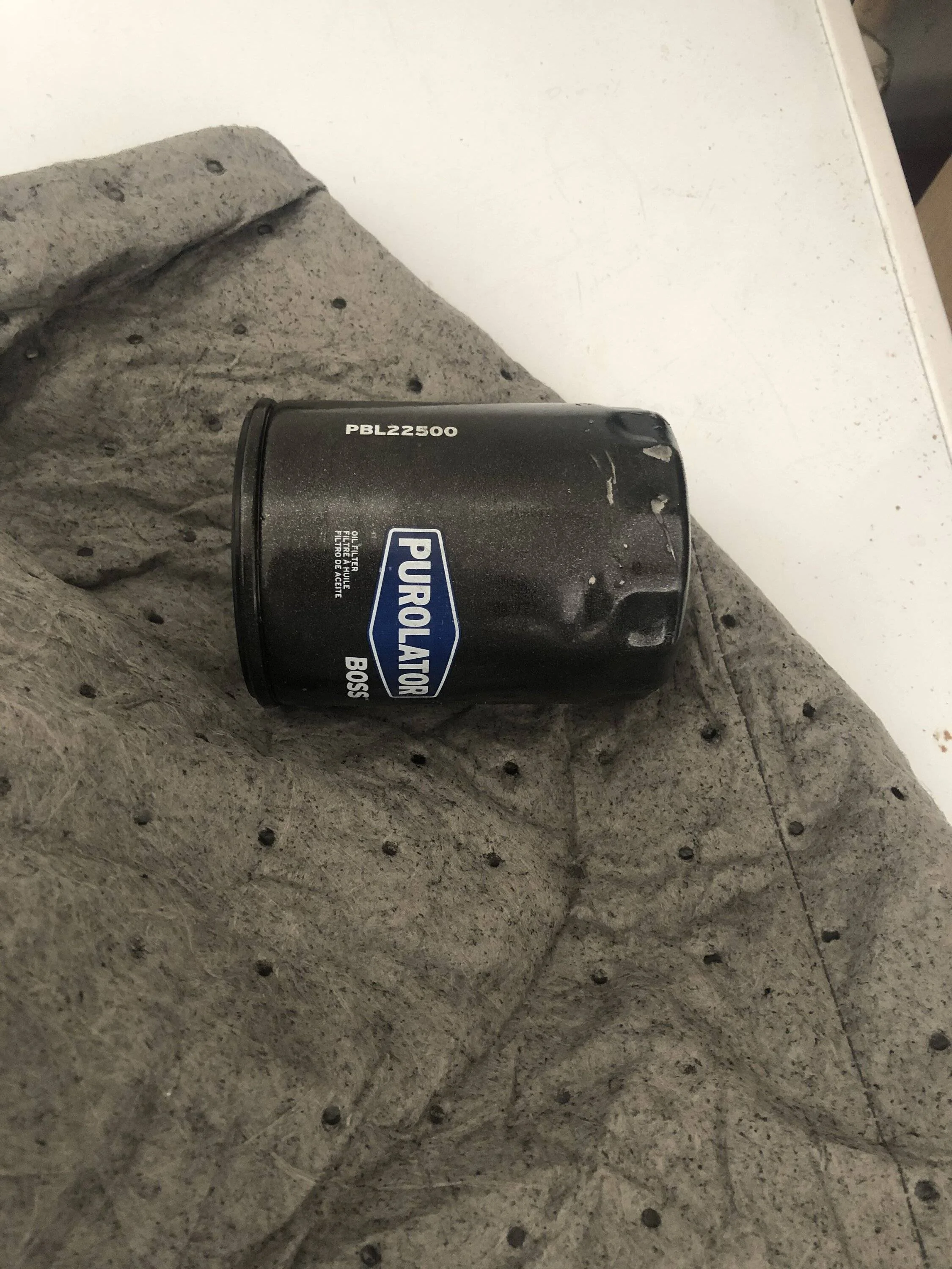

does it sound like this:
I thought the bbq tick was heard more on the passenger side of the car? The ticking noise I have sounds like something metal that is opening and closing, and it is coming from the front center of the engine.
Does it sound like this: c video! If it does, use this filter. This took care of my 2020 pp2 BBQ TICK.
