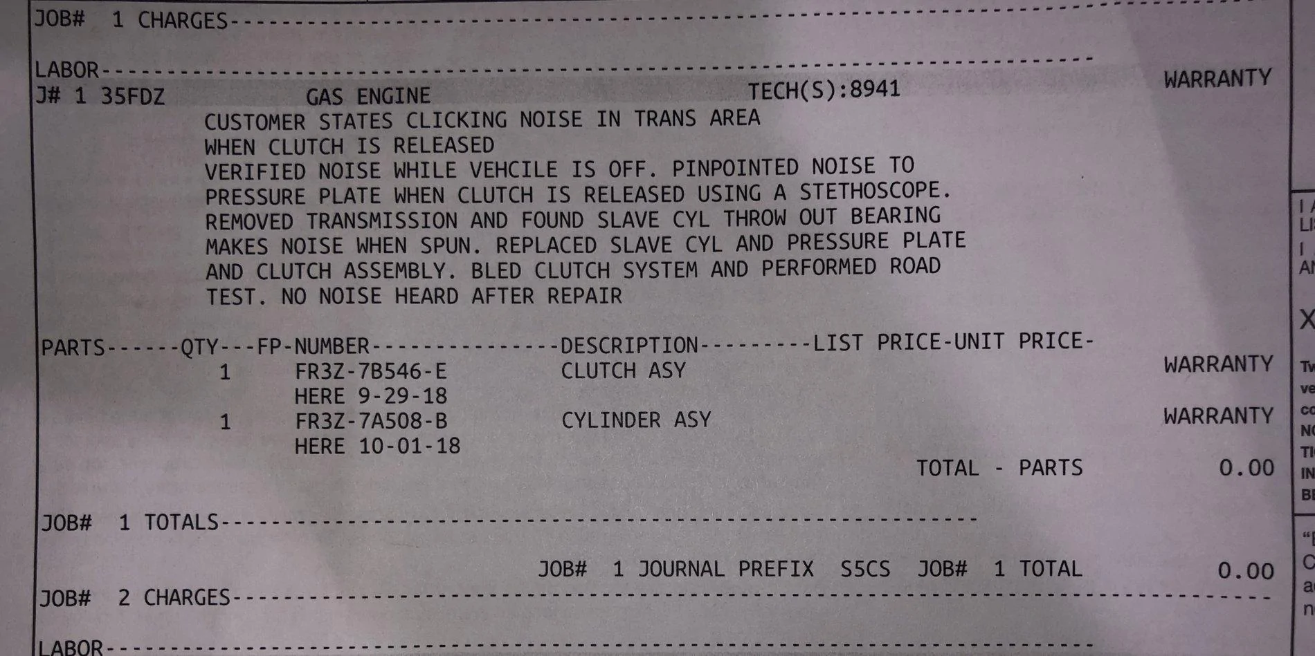

Shoot... Hate to say it,It’s not an easy fix.
There are clips holding the spring on the pressure plate assembly. One of those clips came loose and they had to replace the whole assembly. They also replaced the clutch because it was wearing unevenly (not sure that is totally necessary). I’ll try to dig up the work order tomorrow.

Wow... I appreciate it. Im scheduled to take it in on Friday. Now im wondering if this is going to cost me a couple hundred or if I am going to venture into the thousand range. :( Thanks again for the help!

Thank you so much for posting that. I was looking at my warranty information and noticed that I am still covered under the powertrain portion. Hopefully this will be covered, but who knows.
Thanks again!!

Awesome! My service adviser told me that he thought this would have been covered under the powertrain warranty.
Just FYI - my clutch felt much better after I had this service; I started to wonder if there was a problem since the car was new (even before the click). I sometimes had trouble pulling away from a stop light in a smooth manor before the service. After the service, the car is much easier to drive.
