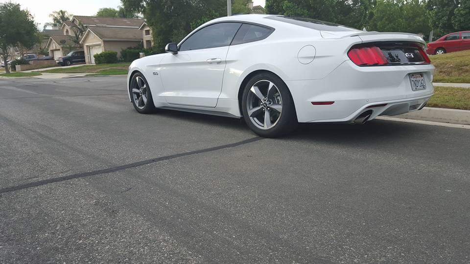

rob
17 lightning blue pp LFP 670
same i got them cause most springs make the ass end look lower .. im on the shitty 18 inch rims for now till next spring then going 20s
thats a pic when i first installed them they settled a little and its about another 1/2 inch lower all around

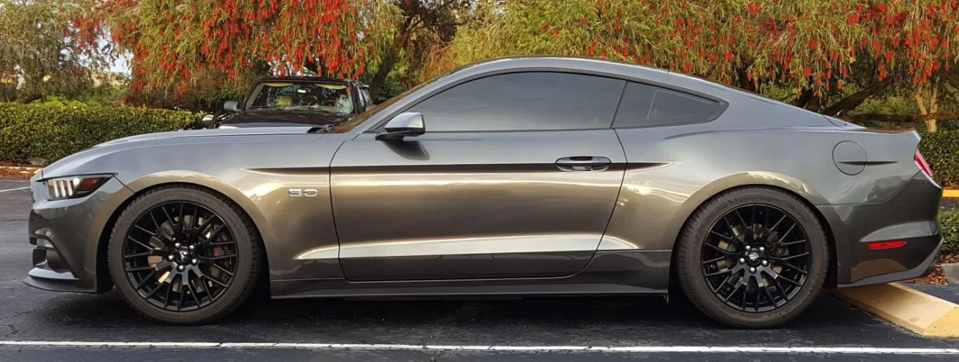

I've had them just about a year. 275/40 squared with 1inch spacers. Zero issues.
Ride is a bit stiffer, but not harsh. Handle better than factory PP setup. Bounce feeling is no more.
