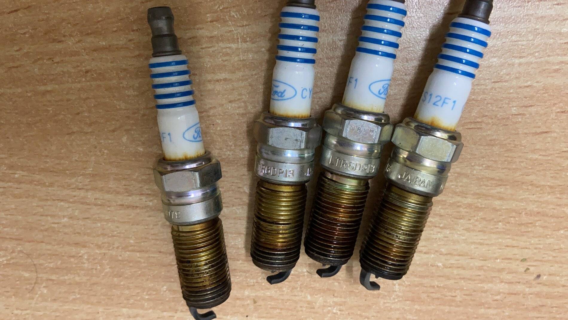

Took it to my mechanic, he checked the spark plugs and replaced the 8 of them. He did this without checking the car with an OBD. Do i have to check it with an OBD or this was the problem ?
Those don't look great and he may have just assumed they were the misfire cause. It strikes me as odd that he wouldn't bother doing an OBD check. If I had to bet, I'd guess he did at some point.
