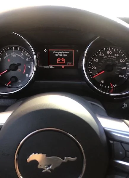

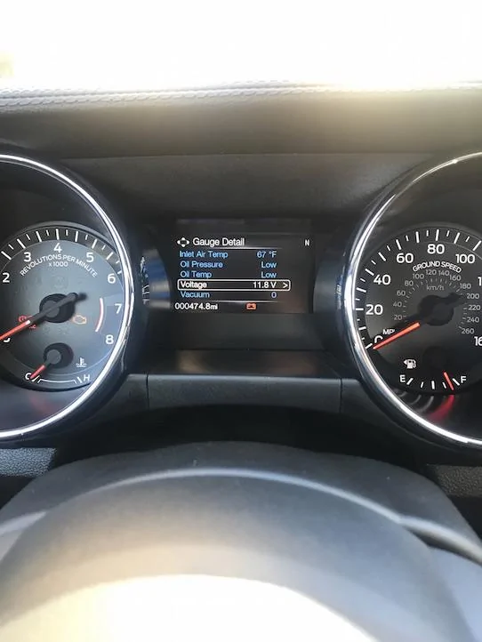

Went to turn on my car yesterday morning and it would crank but not start. A battery lit up on the dash and I also got a "Service Charging System Now" message. Let it sit for around 20 minutes and then it started right up. Used it throughout the day just fine but then this morning exact same symptoms.
Car only has ~400 miles :frusty:. Have a catback system and is otherwise stock. Already have an appointment for Friday. Would like to find any information I can before then. Thanks

It could been discharged already. i would go on a long drive see if you can repeat it.
It could simply be a bad battery. Remember these cars sit at the factory for at least a couple of weeks before taking delivery.

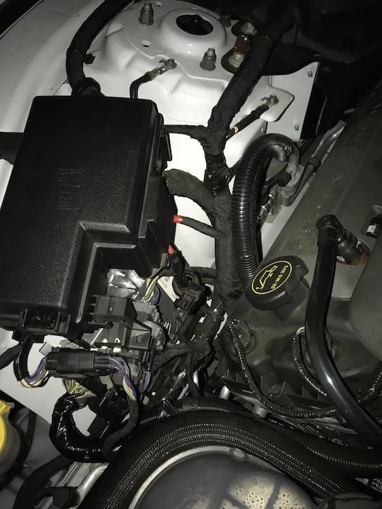

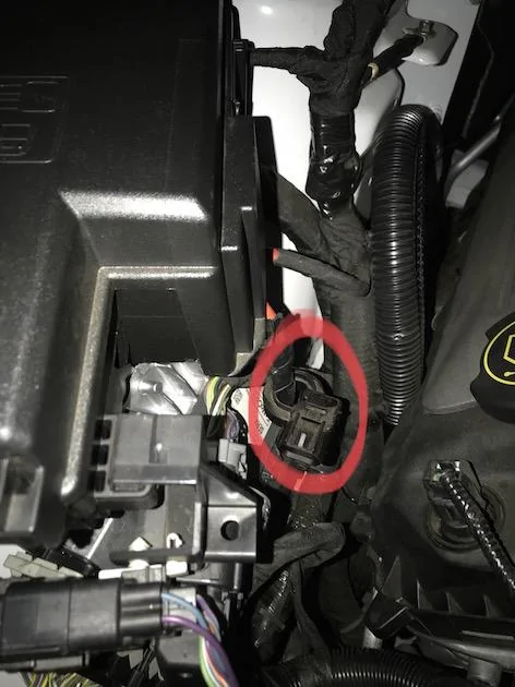

Checked the engine bay at home and there seems to be a connector that has nothing attached to it. Is this supposed to be like this? Thanks in advance.

This was really bugging me even though it's dark out already... So I went to inspect again with a flashlight and found the other end. Connected them right up.
Does anyone know what this connection is for?

It's a current sensor that allows the car to detect if there is current being drawn when the car is shut off. The car has smart charging and battery shut off when below certain voltage. Maybe this plug was never connect from the factory and that's why you are having some issues.

I see! Thanks for the detailed information.
However, it is really unlikely that it wasn’t connected prior to being at the dealership. That area was worked on by them due to the PCM being replaced.
