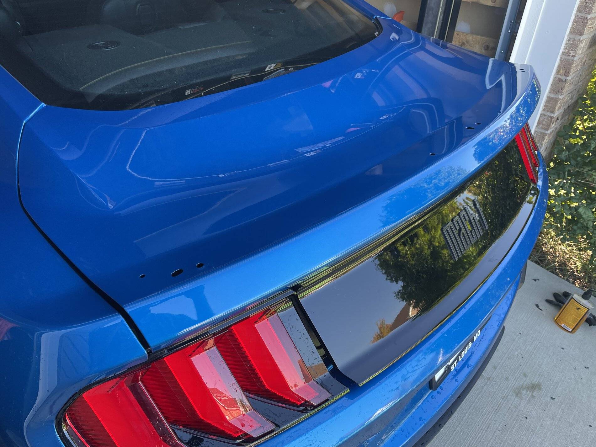

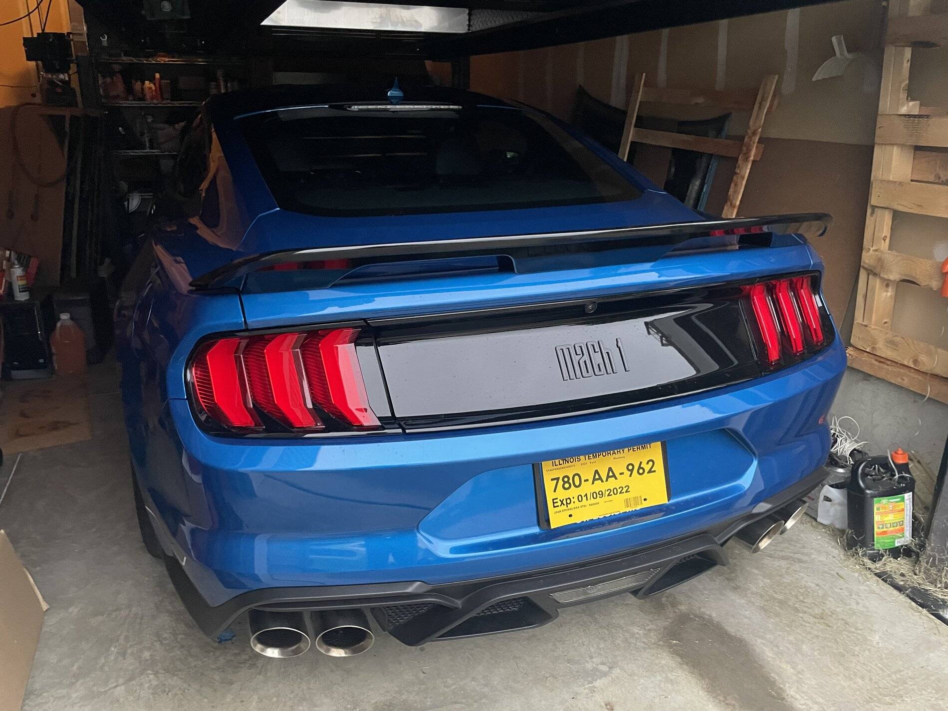

The existing flat one has 1 bolt and a plastic retainer on each end and two bolts in the middle. The aftermarket has multiple holes on each end and two in the middle. I reattached mine with just four bolts and some 3m double sided tape. Here's a picture of the trunk with the spoiler removed. More specifically the stock one was held with nuts and the studs were attached to the spoiler, but the aftermarket were screws. I installed threaded studs into the new spoiler and reused the nuts.
EDIT: Use a heat gun, seriously. It helps SO much getting the factory adhesive off.
