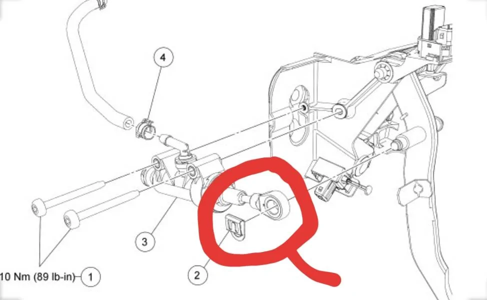

So I recently broke the plastic eye that connects the clutch master cylinder to the clutch pedal and it made a click noise every time I pressed the pedal. So I got under there and pushed the piece back (still broken so will need replacement) on to the "holder." Now everytime I try and start the car I have to put my foot on the break and clutch and push and hold the button. After a minute of running it will enter Limp mode. And say transmission problem, of course I don't have a tuner I can read the code with so I'm a stuck point and next week will be taking it in to fix the broken piece. Is there anything I can do to temporarily remove the code? And how much should I expect to just replace the eyelit?

Sounds like the limit switch on the clutch and/or brake pedal is not right. I would start by checking your brake light is in fact off when your foot is off the brake with the engine running.
There are 2 limit switches on the clutch pedal, one for the starter interlock and one for cancelling cruise control (when you barely touch the clutch while in cruise).
I suspect there is something amiss in that area.
