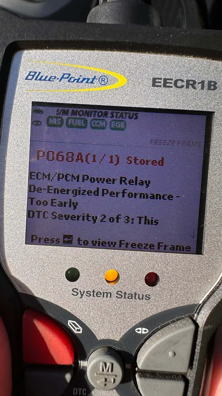

so i have a gen 3 ported intake pmas fender well and lu47s. car is running horrible tuner tried so many different things car just keeps going lean and rich. when i do a pull car hits limiter and doesn’t shift. im not sure what it could be fuel pump sounds good waiting on ford performance to get back to my about my injectors and i checked and dont got a leak. these things only happen when i put a new manifold so im not sure. i had the stock manifold and intake with lu47s car ran just fine. let me know what else i can check thank you🙏
