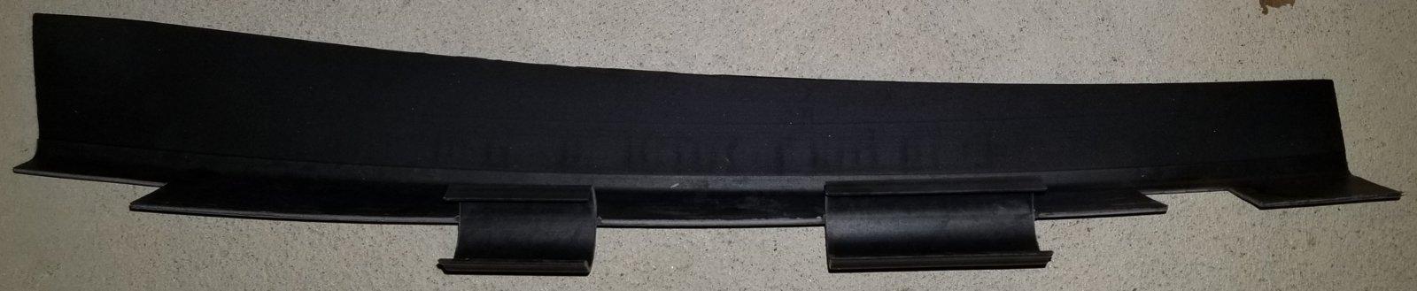

Can anyone ID this part?
rtg
Mar 29, 2018
38
323
212
CT
Rob
2018 GT PP1+

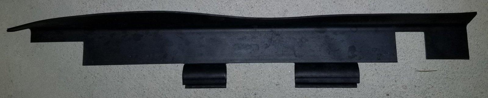

This part was laying on the bottom pan and I found it when I dropped the pan.
I have no idea where it goes.
If you know where it should go please let me know.
Thanks in advance,
Rob

Take it to your Ford dealer and ask them where it goes,might even be able to see it on a car.

It Ian air deflector that clips on to the receiver dryer of the actual condenser to help air flow threw the cooling module

Sorry air conditioning condenser, Damm auto fill

I had the delivering dealer do some work and they must have knocked or left it off.
Does it clip on to a tube or hose? Also is it vertical or horizontal in position?
I looked around and could not see a hose of the correct diameter for the clips.
Can it be seen from the top? If yes, any chance you grab a picture?
Thanks in advance,
Rob

It clips to the receiver dryer I removed mine when I installed the inner cooler for the supercharger . I had my bumbed cover off at the time . You might be able to get it back in place by removing the lower filler panel under the bumbed .It is mounted in a horizontal position
