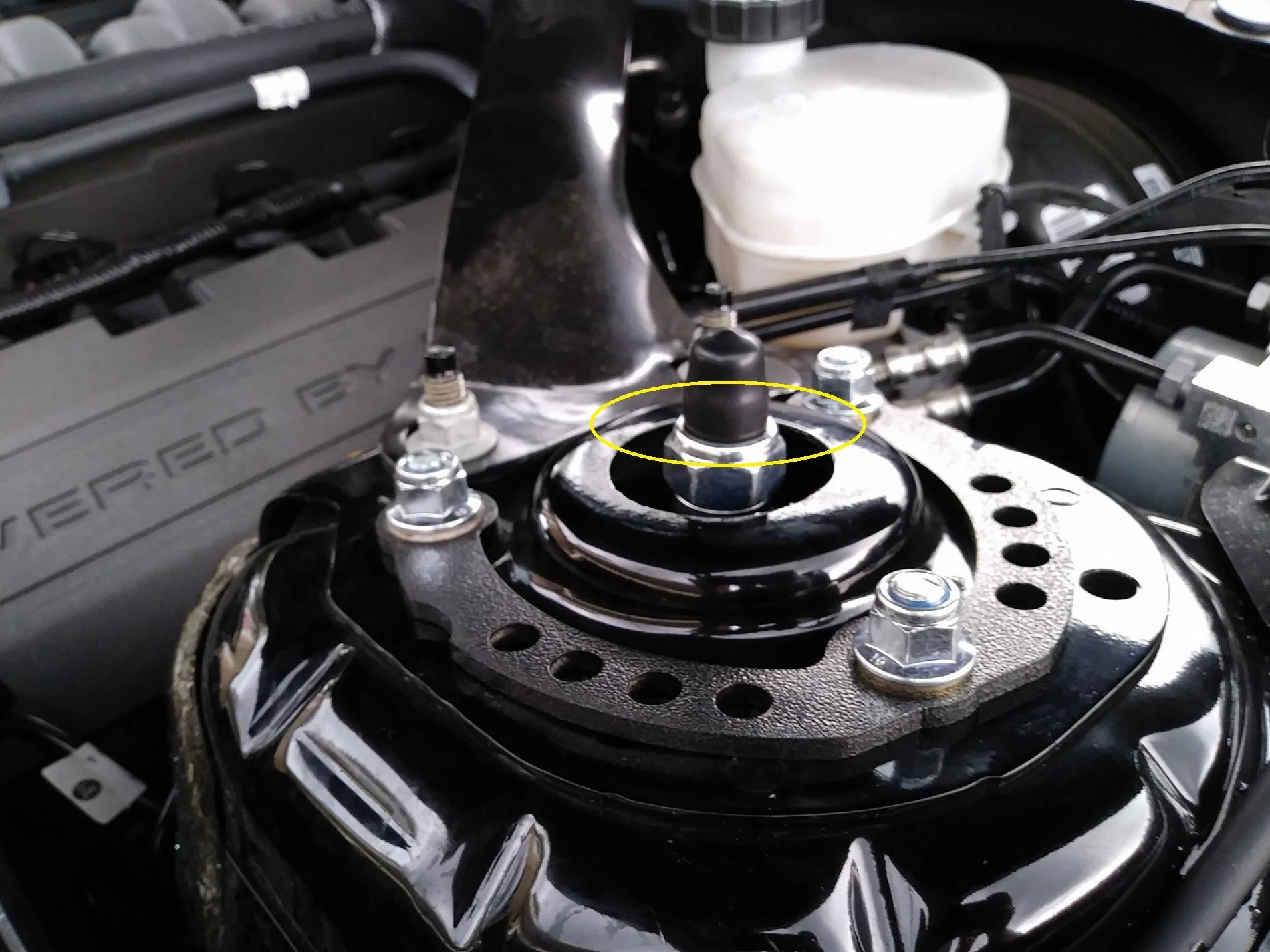

so it appears the whole camber plate and spring were rotating..... what would cause this? the spring was seated properly on the mount but twisted big time on the bottom
https://imgur.com/a/J4jhZ
Also, could this have caused any damage to anything? obviously i need new mounts, but what about the shaft and camber plate?

You have them upside down....
Flip them around and all your issues will go away.

I have seen this happen once before, so don't feel bad. Stuff happens.
Don't hesitate to hit me up if you ever need any help with anything.
