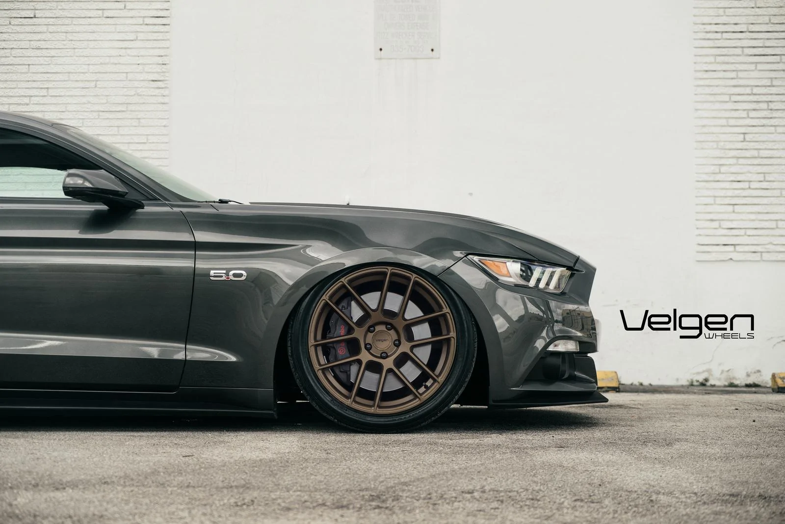

I originally had a 20x10 with 275/35/20 in the front but swapped it out for a 20x9 with 255/35/20 and glad I did.
I just wasn't comfortable with how close it was to the fender. Even with running negative camber. Which wears the tires even faster.
Look at the couple of pictures posted above. If that wheel is not perfectly straight when you air it out. The fender is going to take a hit. I was always paranoid when I would air out the car waiting to hear that crunch sound. Luckily, it never happened.
With the 20x9 and 255/35/20 I have wiggle room if that wheel is not perfectly straight and that fear is no longer there and I am running no negative camber.
