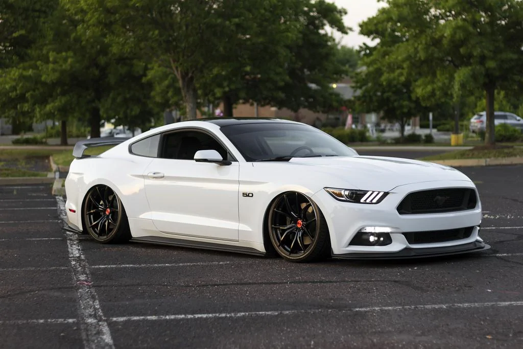

20x10 +40 Rays Gram Lights 57fxx all around. 275/30/20 Hankook Ventus V12 Evo2. 5mm spacer up front. My setup isn't very aggressive so i have no problem with rubbing, and i can fully air out the car.
I really like your setup Colin, its sick as hell.

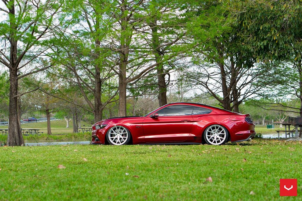

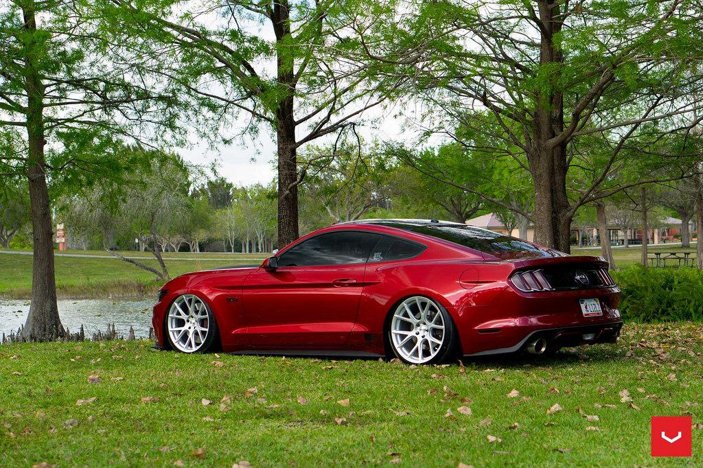

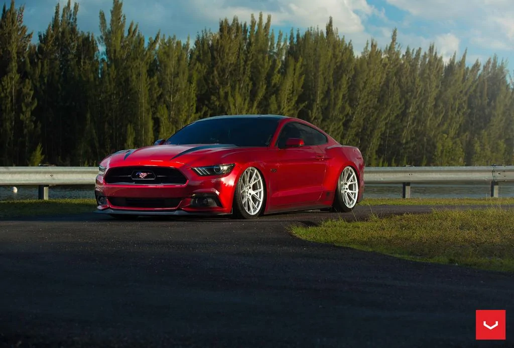

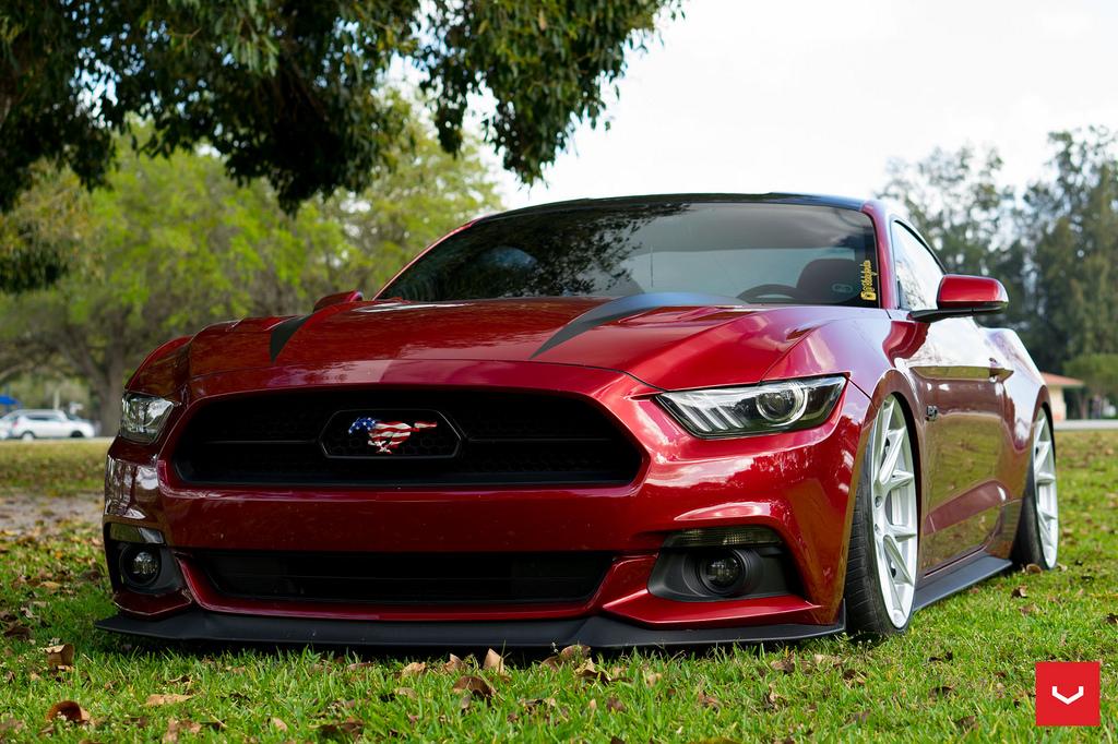

mike@vossen
Sep 8, 2014
74
1,346
487
Miami
www.youtube.com
2017 Roush Stage III

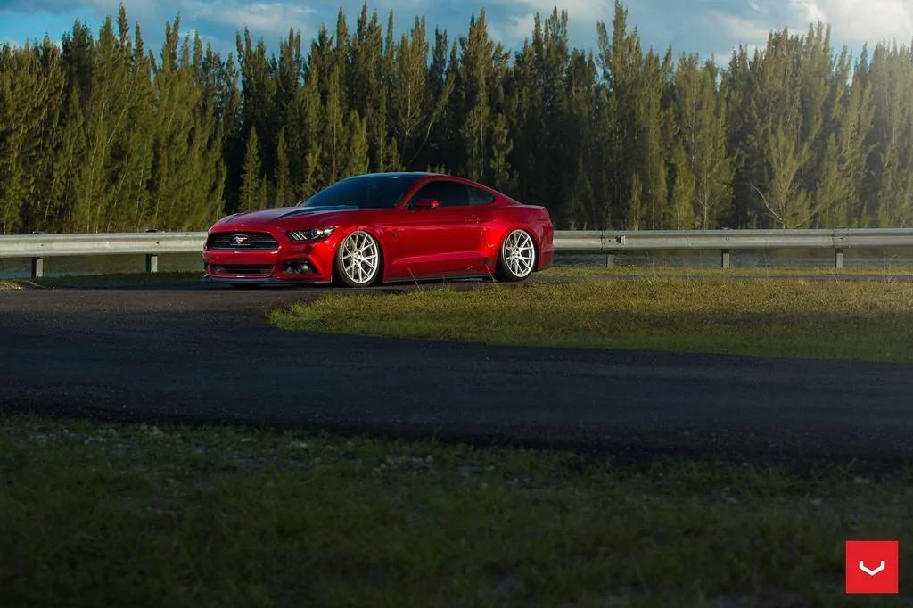

We all know how badass the new Ford Mustang is and this bagged one raises things up a notch while lowering down on air with our new VFS-6 wheels.
Read more here on our Blog - Ford Mustang GT on Vossen VFS6
[ame]
Vossen VFS6 - Gloss Silver
F: 20x9.5
R: 20x10.5
