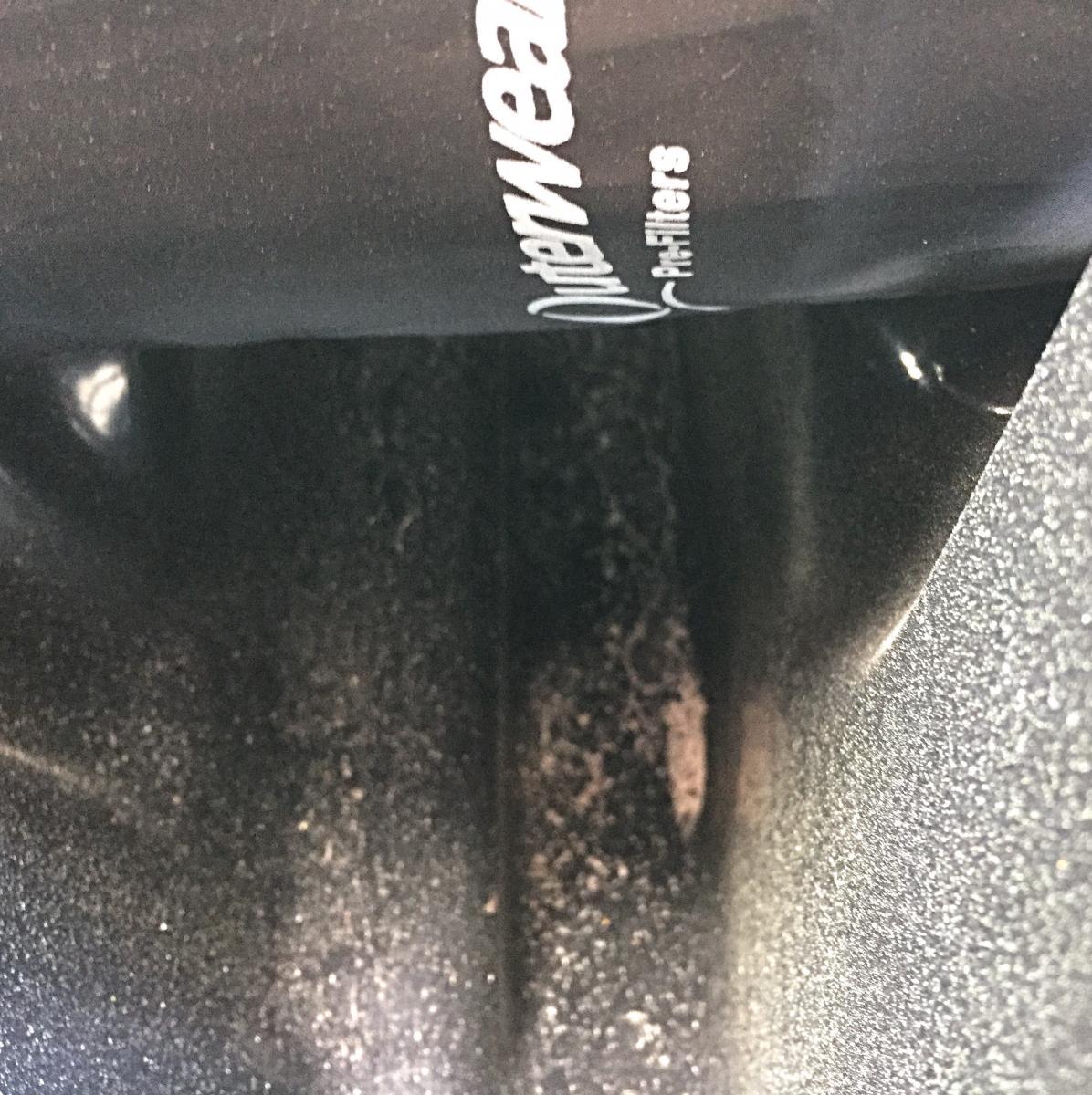

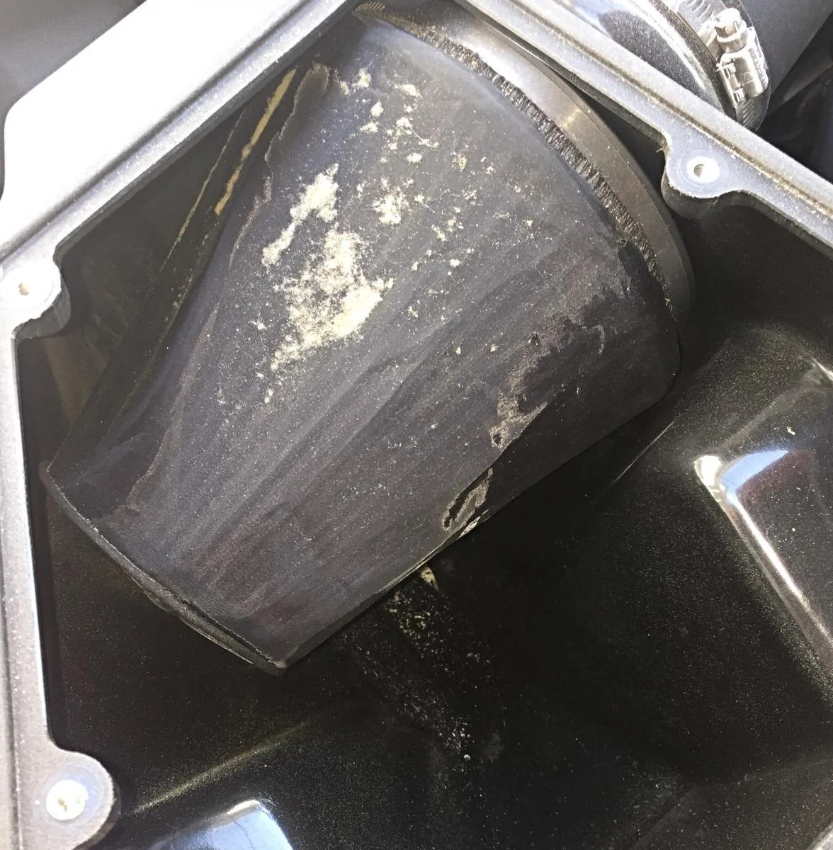

I just looked at it today, which is after it's been on for approx. 5,000 miles. Judge for yourself - the pics represent exactly as found.
As seen, there is quite an abundance of dust, particulate debris and sand particles not only on the exterior of the sock but within the box itself. Granted these type of conical filters are supposed to filter well, but they don't filter "everything" and this debris actually plugs the pleats in a filter w/o such a sock.
I highly recommend this inexpensive "mod" to any S550 members who are using either a closed or open CAI system with a conical air filter. This additional layer of protection is 100% WELL WORTH IT!!
1) It cuts down on debris getting past the filter element material
2) increases filter life
3) water repellent
4) maintains improved performance due to no plugging of pleats
5) best of all it reduces filter maintenance three-fold. All I have to do is open box, vacuum off sock and interior of box - done in approx 10 mins.

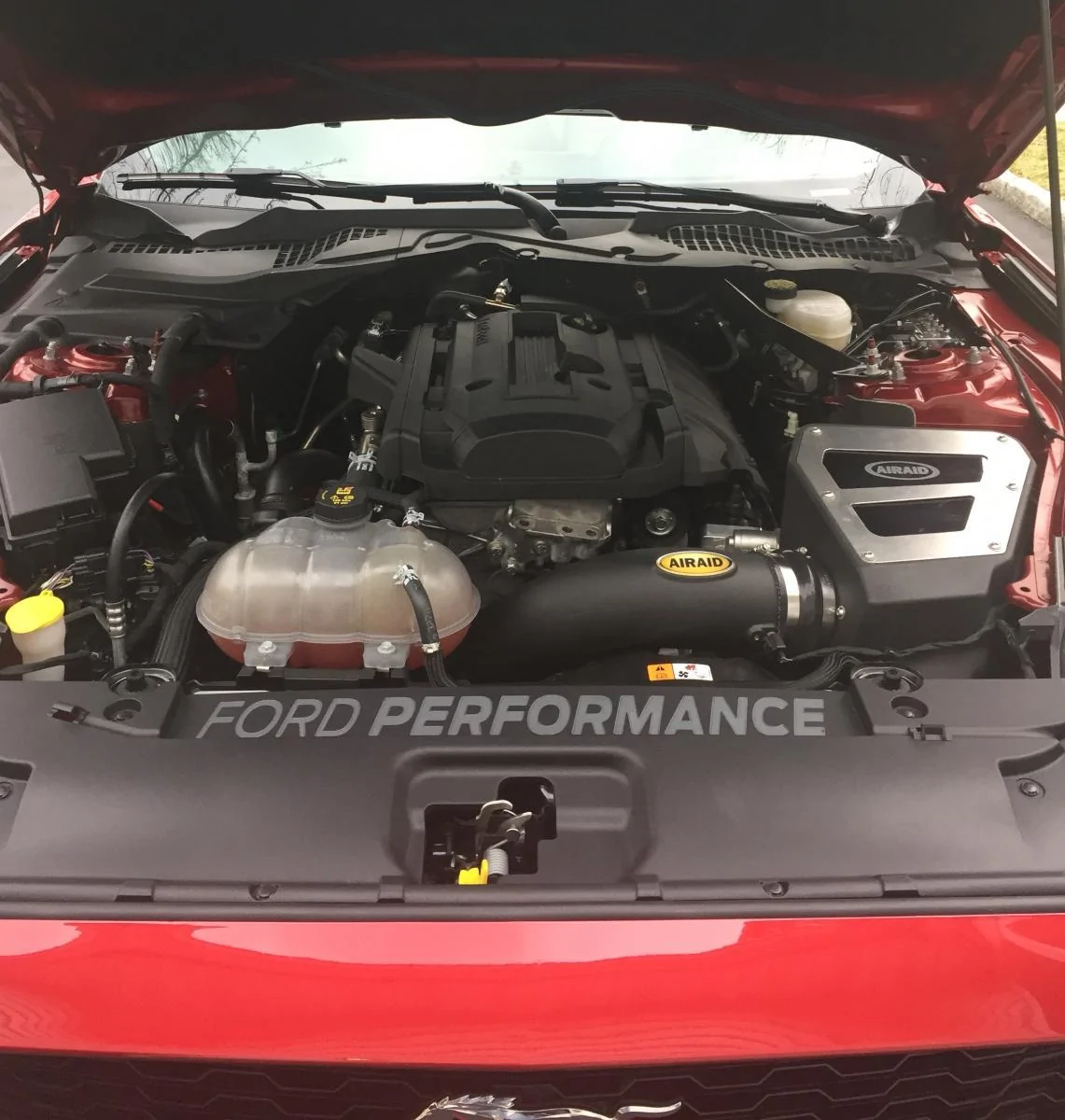

Your engine bay appears extremely dirty. Can we have more pictures of it?
My entire engine bay is clean - in fact just as clean as it was when I bought it new - and it's daily driven with 25k on it so far.
The dirt you see in the images I posted earlier is of inside of the Airaid filter box - that is what would normally get sucked onto the filter. In fact, even the stock airbox gets that type of debris in it too on a daily driver.
Pics of my engine bay as requested:

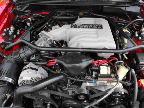

And not to get too far off topic, but here's a pic of my 94 Cobra engine bay for reference - looks just as new as when it was delivered to the dealer in 1994... and this one has 144k miles on it, yes original engine/drivetrain. This car too *was* my daily driver, in all weather conditions.
:cheers:
