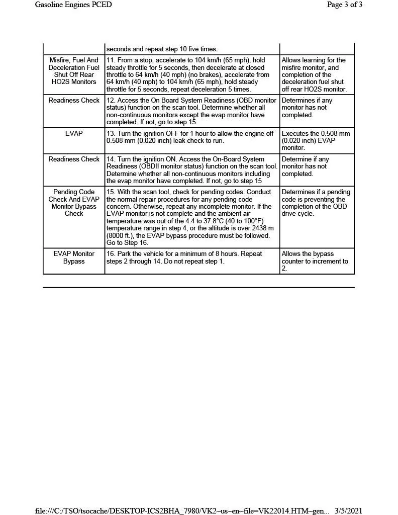

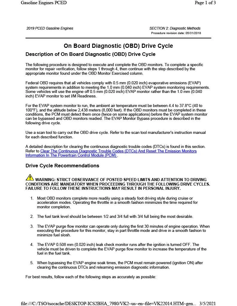

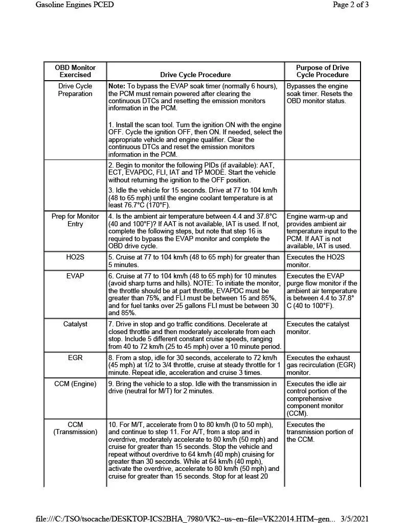

I actually just got mine inspected in ny. I did have a flex tune in it where the rear o2s were shut off. I didn’t think it was going to pass but I figure screw it let me see what happens. It failed as the oxygen sensors were not ready. I put the 93 tune in it and bought an innova obdii scanner from autozone and drive it for a couple hundred miles. All of the emission tests were green except for EVAP. I think this might be a tricky one to get actually perform the test. From what I read on line it took people several hundred miles for car to perform test. Even with this test not performed my car still past inspection. I know it’s not ca but from what I understand EVAP is not a smok test. In summary not bad to get a scanner so u don’t waist time and money at shop, drive the car the best you can based in the drive castle above and scan the car after a couple hundred miles. Hope this help a little bit and good luck

Drive cycle above(trying to type too fast)

I'm going through something similar with the O2 and Heated O2 sensors. The drive cycle sheet put out by Ford doesn't list these two so I'm not sure if there's something special that we have to do for them.
