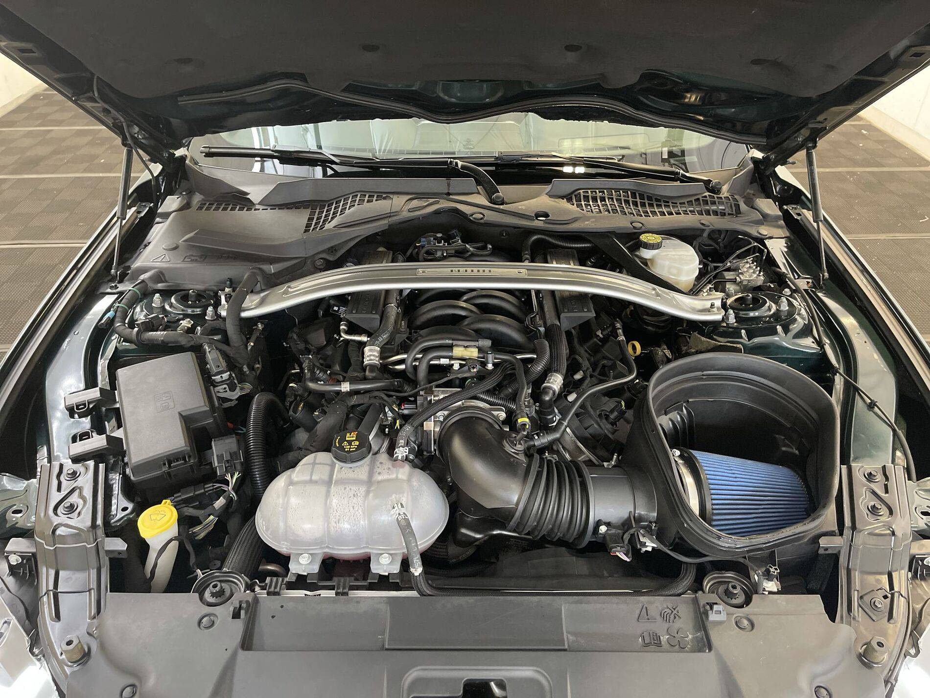

The blue Ford Performance filter is more expensive, but is a dry filter. The K&N is an oiled filter. You decide, but I prefer the dry type as they don't contaminate the mass air meter, the oiled type can, if they are over oiled.

Here's the blue one in my Bullitt; Roush struts. BTW, Vroom is going to lose money on mine, they're advertising it for less than they paid me for the car.
