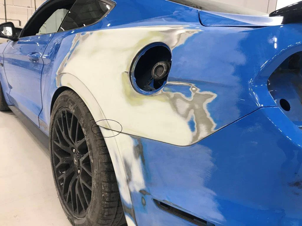

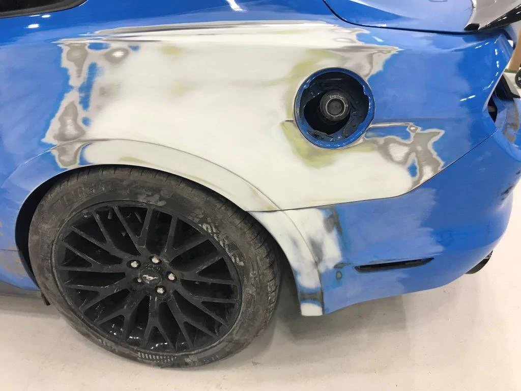

Judging by the photos of the initial panel work I think it’s definitely preferable to go with the panel repair option rather than a new panel.
It may also result in a quicker repair rather than having to wait for a new panel to arrive.
The very fact they are happy for you to look at it before any filler or bondo is applied is a good indicator of the quality of the repairer.

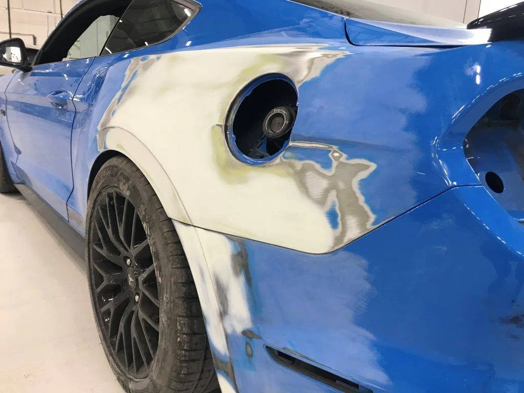

i called up today to have a good look at it and it seems to be coming along
my only concern is them creating the crease at the other side of the petrol cap - i've a funny feeling it continues ever so slightly?

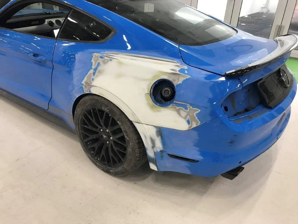

that, and the new panel gap that opened up between this panel and the boot lid

@bobpies - the line on the left side of the cap continues for approx 50mm :like:

Unless your car is written off it does not show up on a HPI check. Worked in a Ford Bodyshop for 20 years now as panel beater and Damage assessor. Some of the assumptions on this thread are hilarious:giggle:
Fuel tank removed is for safety and will be in the manufacturers published repair methods, roof paint blend will be to avoid a large masking line down your roof gutter too.

This ^^ I worked at a Ford plant for a few years so I pretty well understand many of the repair intricacies when it comes to body panels and paint. Repairs don't just affect the immediate area, there are lots of prevention methods for damaging other components (i.e. fuel tank as you mentioned) as well as blending paint and specified weld areas. It not as simple as "let's cut this right around the damaged area and put a new piece in".

@bobpies - As they are painting and then re wrapping the roof, have you thought of just having the roof painted in black as per the factory option ?

that was only happening with the replacement panel route - I don’t think they are doing that with beating it out but I’ll double check with the engineers.
imagine paint would be quite a bit more expensive

I wouldn’t fret looks like good quality from images

Is this area aligned? Looks like the upper part may be sticking out more than the lower.
