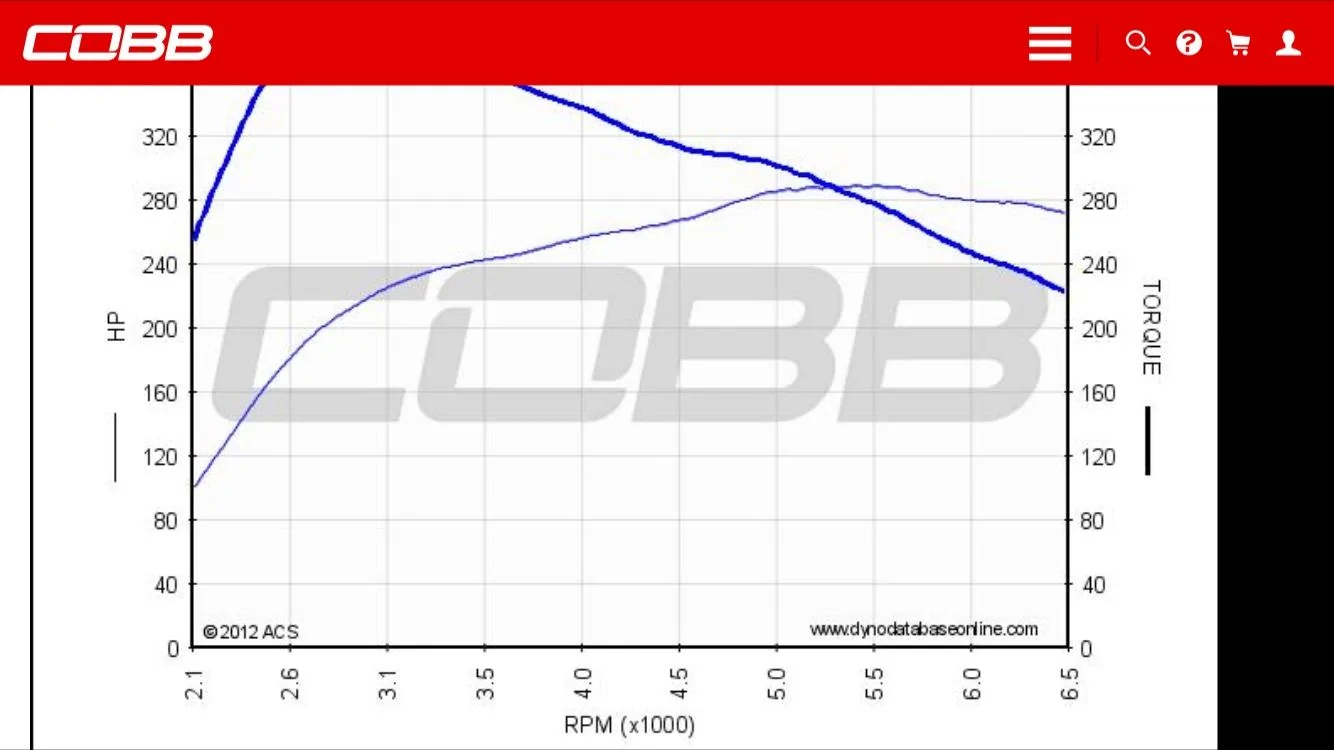

Forgive me if I'm wrong but I thought hp only mattered above 5250 rpms. If you dropped to 4k rpms you'd be up 60 ft lbs of torque. The way you worded seemed to completely ignore the torque all together.Not if you take into account where your gonna be after you shift at the peak. Say you shift at 5500 before it falls off, your next gear pull will be in the 4K range with way less power than you would of lost by taking it to the top then shifting and staying in the higher hp power band. If you take the average time under the curve it's ok to drop a few hp at the top if because the average amount of time you'll be in the curve at a higher hp will be more.
So it's important to see the powerband all the way to redline to see. For instance, Cobbs peaks then only lose 15hp to the redline. I'd rather take it to the top and shift and start my next pull in the higher hp range than shift at peak and start my next gear pull low in the rpm range at 40hp less.
