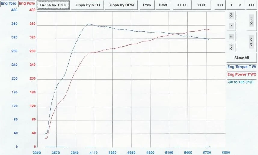

I just noticed this is the + with the bigger compressor wheel. It still seems to spool very fast if I am right assuming that where the graph starts is where WOT starts.
Do you know what boost level this is at?
I usually get up to 25 to 26 PSI at WOT with the current tune. For my 3rd gear datalog pulls (going to WOT at little below 3K RPM), boost curve looks similar between the stock and VS2+. Unfortunately, I didn't do a datalog of idle to WOT when I had the stock turbo, so I can't do a measured comparison.
VS2+ feels like it spools up almost same as the stock unit, but having AT and 3.55 diff could be offsetting any lag increase.
