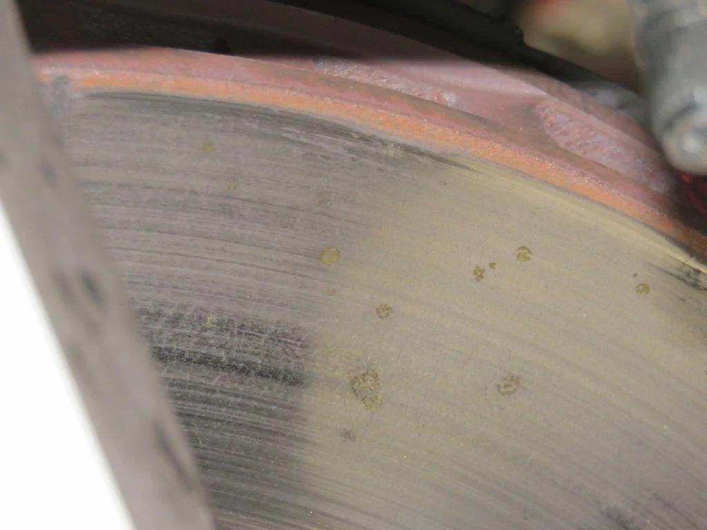

My PP brakes are down to probably 50-60% pad life, and have seen some hard use (track events).
While touchy/grabby when new, they no longer feel 'grabby'. Its possible I've gotten used to them, but honestly I think the grabby initial bite has worn off. I've done multiple brake fluid flushes with no effect on initial bite characteristics, and there is brand new Ford fluid in the lines right now, so I don't think due to old fluid.
Anybody else think their pads have lost that initial bite?
I'm going to guess that you managed to overheat them, if perhaps only slightly.
Norm
No doubt I likely did. So implied damage to the pad material or rotor? Fluid has been completely flushed

Pad material.
But take a look at your rotors, looking for heat checking (funny little lines that run in somewhat random directions). If you can catch a fingernail in any of them, replace both rotors on that axle.
