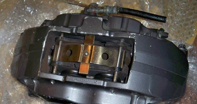

This is not my mustang but a 2006 supercharged range rover I picked up.......Replaced rotors and pads with Powerstop drilled slotted rotors w/Ceramic pads.......What is this noise?

I'm going to check the suspension components also, its just odd that this only began with the rotor/pad change. I keep everyone posted when I get back to tackling this........Thanks for your input.

Go out and test them in a safe area. Start by making sure the brakes can overpower the engine; if you can make the car move with throttle while you are stepping on the brake pedal then something is wrong, do not drive the car. Then test at slow speed (which it seems you already have), progressively work up to higher speeds. If the brakes bring the car to a stop in what appears to be normal distance and the car is not pulling then the brakes are working. Take a peek at the rotors. If the car is stopping normally and the rotor isn't showing an abnormal wear pattern then I think you can rule out a malfunction or assembly error.
At that point I would try bedding in as others have described.
I used to own a Can Am Spyder (it was actually the wife's) which was notorious for its noisy rear brake. With the stock brake you could make it go away with a few hard applications of the brakes, so most believed the problem was heat related; the brakes were noisy when cool. The solution for most people was a change in pad material. If I recall, anything semi-metallic would result in the same problem, you had to use organic. That meant, of course, less stopping power and a shorter service interval on brake pads.
