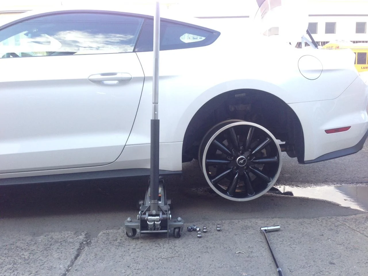

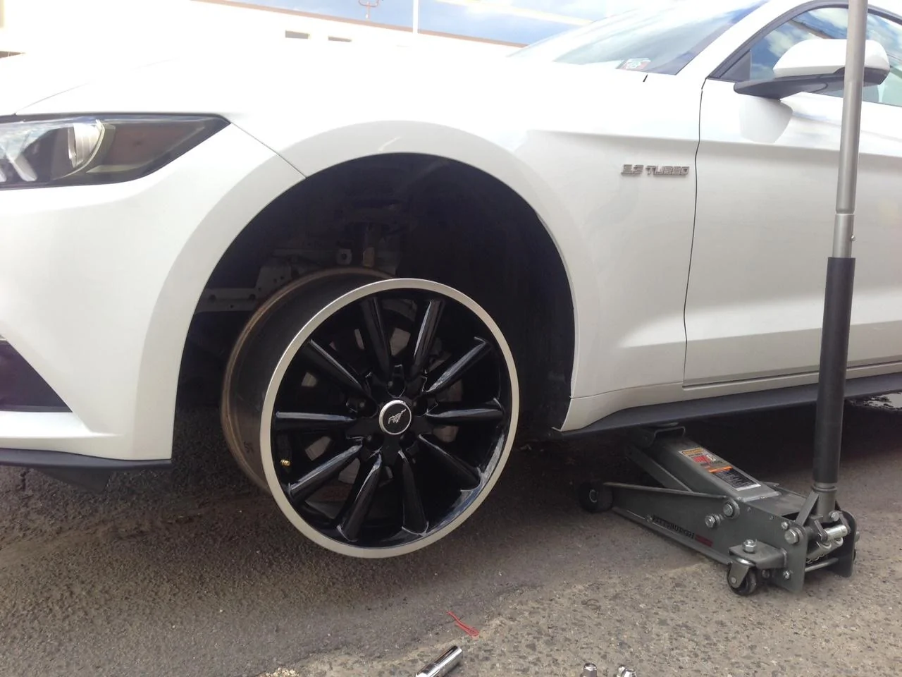

Ok. I got wheels and it was a challenge:-)
First fitment without tires. Tires update soon.
BTW. front rim is only 0.5 inch from the shock. If you put rear on front it's like 1/8 or even close.

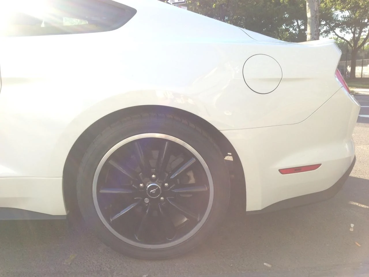

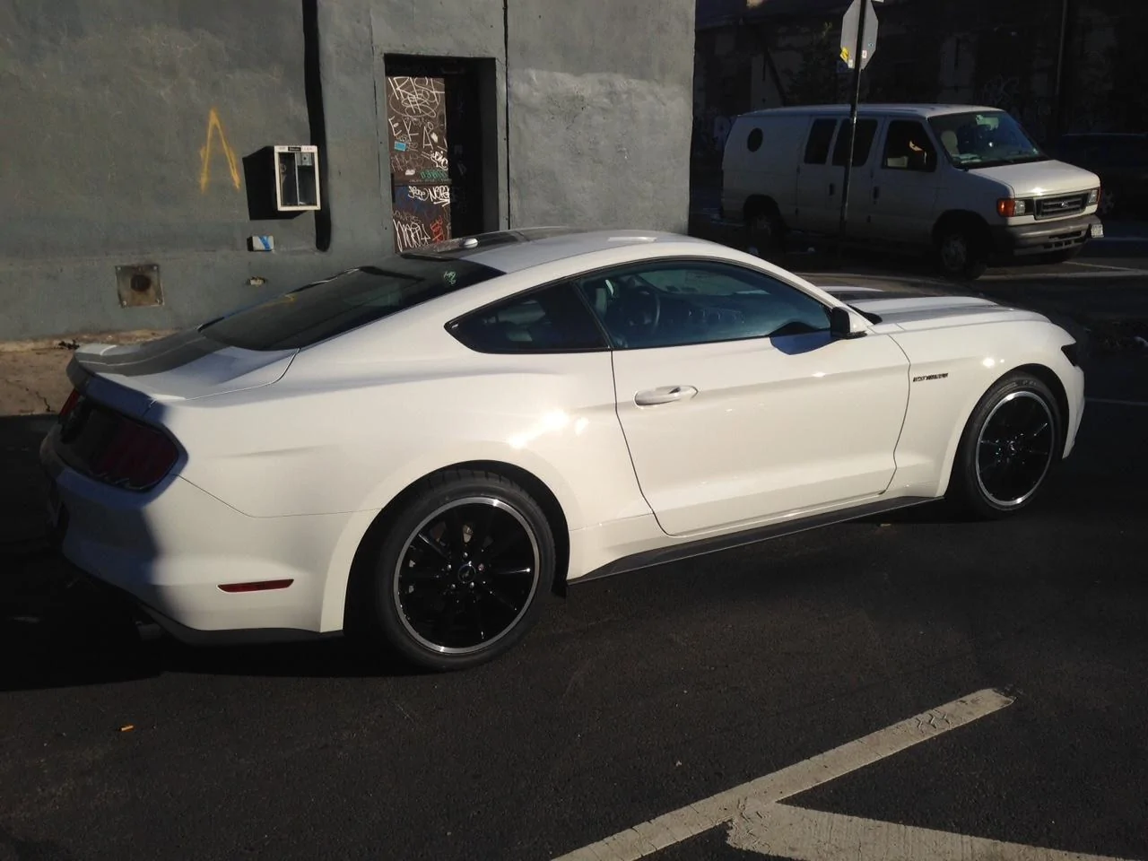

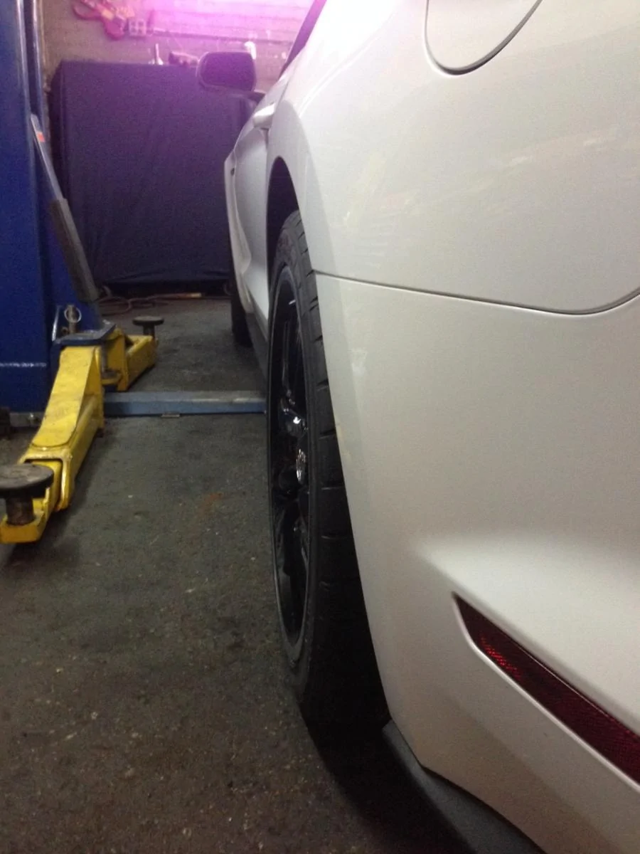

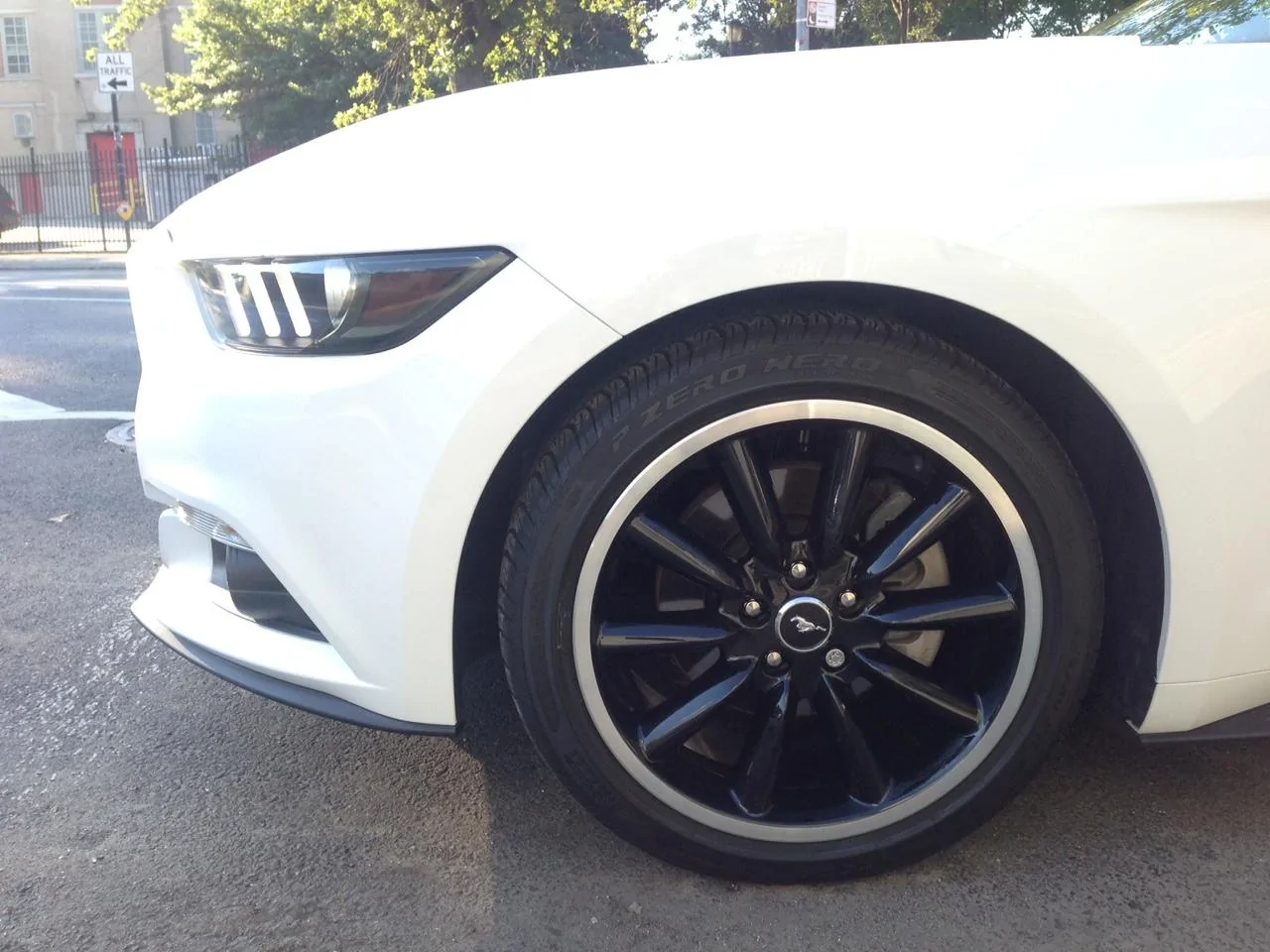

Ok. Here are the pictures with the tires set up. Rear sitting awesome but I think the front went more inside the fender:-) BTW looking good I like it.
and sorry for photos quality. Did it early morning with the Sun shunning from the side.

Nice look with the black stripes.
Look into adding spacers at the front wheels to move the wheels outboard. Better yet, use adapters for even more offset and without stud safety issues.

I have grey silver stripes. But will repaint it into the blue ones. Also I think I will install 1/2 or 3/4 spacer on the front.
