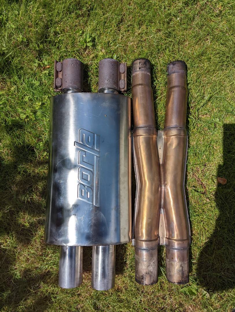

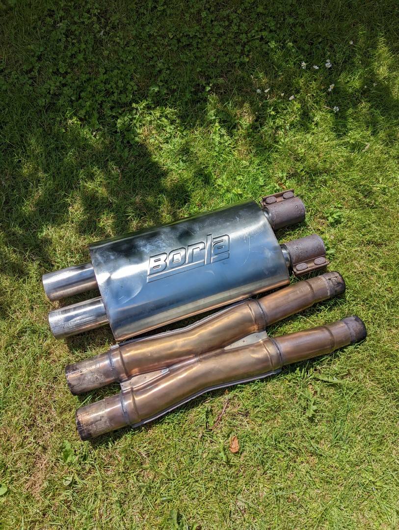

I contacted Borla directly last week as well.
Their answer was that it did NOT fit, and that I would have to use the Ford Racing part. Too late for me, as I had already ordered it :)
However, they are full of **** as it fits absolutely perfectly. The dimensions are identical and it installs without issue.
It also sounds fantastic. Waaaay deeper than the unresonated X, much quiter cold start, way more restful when out of the gas, no drone and im guessing its taken a good 10+ dB off peak volume.
However. Full gas = party time and it wakes up immediately.
Highly recommend if you have de-cat LTs and need to tame down the sound :)
