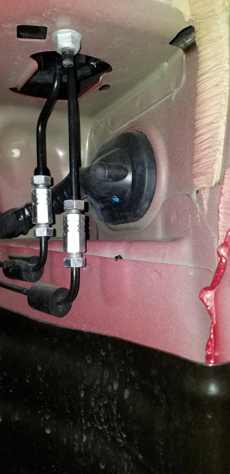

Jay-rod427
Jun 8, 2016
2,422
1,011
Kansas
2016 GT C/S
I used soft 1/8” no issues either. Had it routed all the way to the passenger side floorboard kick panel inside.

Jay-rod427
Jun 8, 2016
2,422
1,011
Kansas
2016 GT C/S
That was my next question. Recommendations on where you guys were going through the firewall. And where you found some room under the dash to mount the box. I have 6ft of line and a 6ft firewire cable to connect the Omega Box to the BDX, which I have mounted next to the radio. I should have plenty of options inside the cabin.
I went through the big grommet that is already in the passenger foot well behind the fender liner. The omega was actually under the fuse panel cover right there. I think it's fuse #26 did an add a fuse for ignition power. But beware it's a micro fuse.
