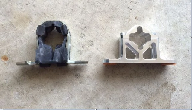

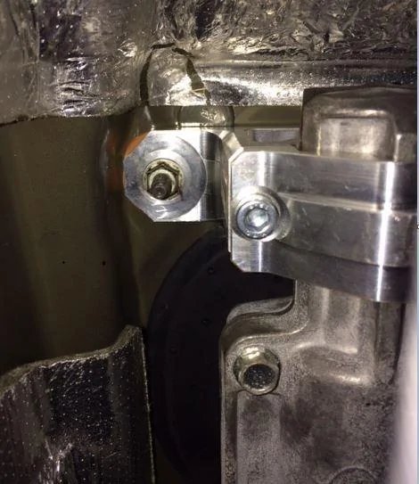

I received my Boomba Racing shifter assembly bracket last week and installed it over the weekend. Removing the stock bracket and bolting in the Boomba one is pretty straightforward. You'll need a 1/4" drive, 10mm socket (deep) with swivel and extensions to get the old one out.
The Boomba bracket is a tight fit and mounts solidly. I use Loctite on everything, so some blue 242 was applied to the allen-headed screws provided with the bracket. Install time was around 45 minutes, done on my garage floor (jack stands of course).
The shifting action feels much, much better. Nice, solid engagements throughout the gates. Fast shifts can be done with more confidence now.
There is a slight increase in cabin noise. It's a lower frequency "exhaust growl" and actually sounds good lol. I have LT headers with the stock resonator and mufflers so it actually sounds decent. Because my car is on the quiet-side of things, you do hear a some gear rollover in the tranny now...but only if you are listening for it. Same for the additional low frequency exhaust note. Not annoying at all. The tranny tunnel is just transmitting some volume through the new bracket. Windows down, you don't hear a thing. Windows up with the radio off is when you hear things.
So far so good.

I have done 40+ quarter mile runs with this mount and have had no issues using this bracket. Launching on drag radials at 3500-4000 rpm. I believe it was money well spent.
The factory mounting points will be fine because all this bracket is doing is isolating the shifter assembly from the twisting movement of the transmission. The shifting rod still allows this independent rotation. But now with this rigid mount, the shifter itself doesn't rotate. With this bracket for example, 3rd gear gate is still in the same location either idling the engine or full throttle pedal mashing. The mount bears the load of the shifter assembly itself, not the whole transmission.
