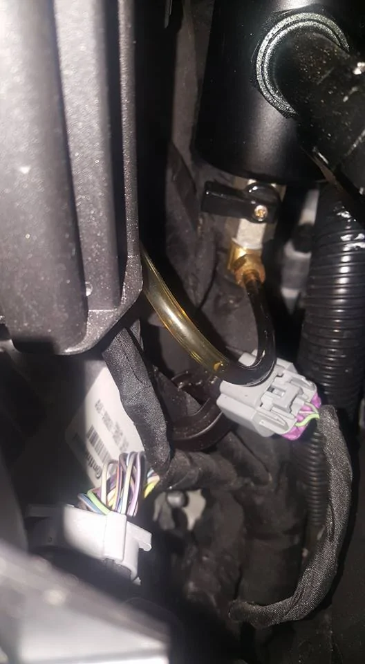

Look at this... The ribbed ac bundle looks to be much more over and the oher wires are more towards the outside of the car leaving a big gap there.
Here i dont even see the metal bracket and its sitting almost above the ribbed bundle.

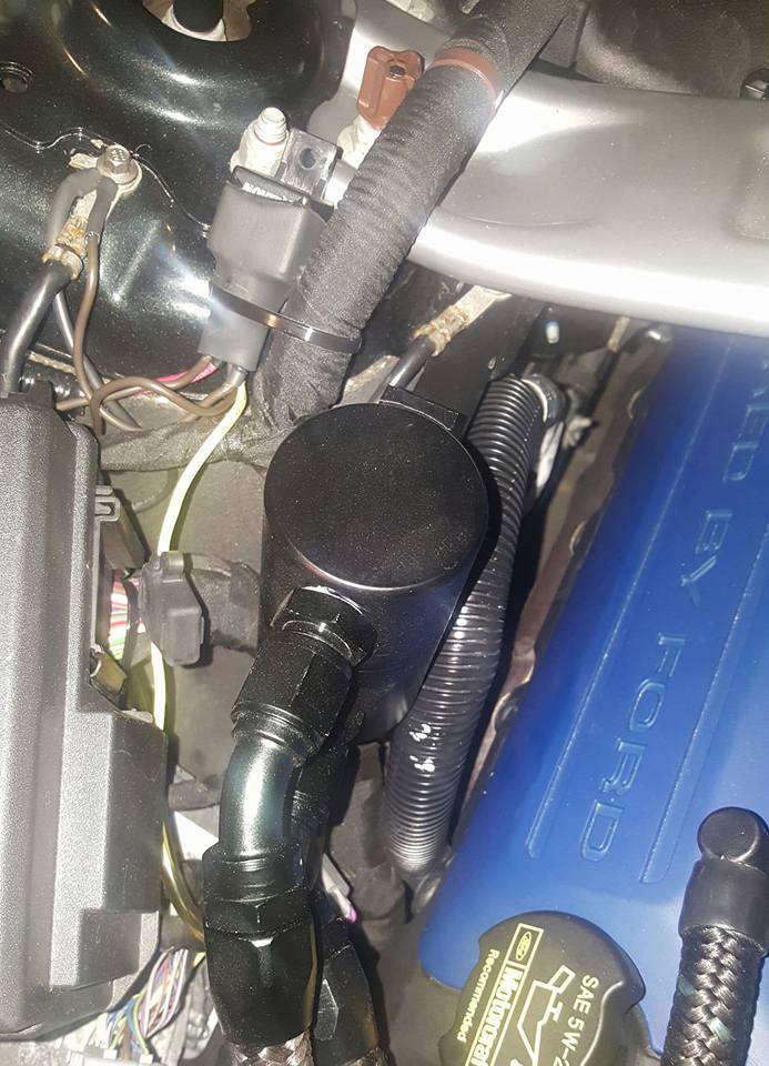

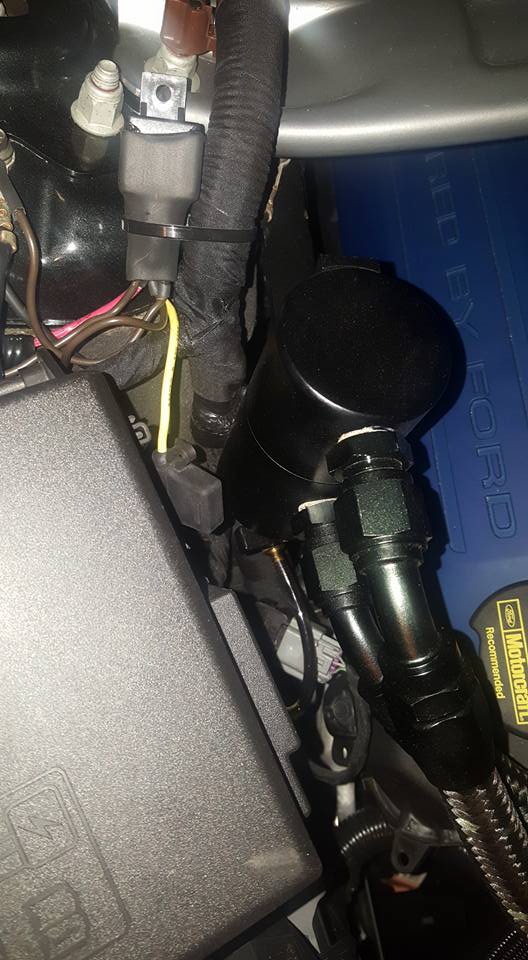

@opt: it looks like you have two things going for you that i dont. Your bracket seems to be longer and your AC lines and harnessed look to be a bit neater and in better positioning. Like i said, even if i wedged it in there as is there will be no room to drain or fit a tube as you have. With a slightly longer bracket the can would be in a near perfect spot.

I didn't think of turning the elbow downwards like in Optimum's pics...that would help with the inflexibility of the hoses (I have the same elbows/hoses).

I have mine set up like optimus's and its maxed out on height. Its still too low and hits the metal bracket or the pipe. Flipping it would put it lower. Bobs already admitted the bracket was wrong after seeing pics and me telling him it was just short of 5". We sorted it all out.

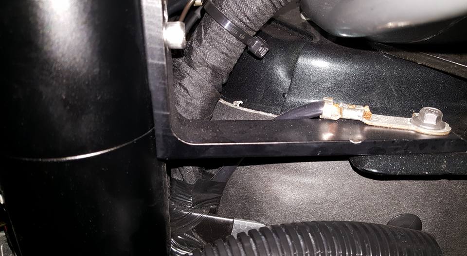

I received the new bracket. I did a quick measurement and it is about the same length within 1/16th of an inch and the part where it attaches to the can is rounded or slotted so it will not adjust or hug the can. I figured it would not fit but i tried it anyway.

I tried for about an hour with each bracket. the bundles that are there wont move and even if they did there would be no clearance underneath to drain it. Another inch or two of length and it would be no problem. This is even ignoring that the back of the bracket wasnt radius'ed at all.

4-7/8" from can to end of bracket, 4-5/16 from can to mounting hole(groundstrap) You will also notice where mine is positioned on the can, in the other hole. I honestly do not recall if that hole was there or not, it's been on a long time.
