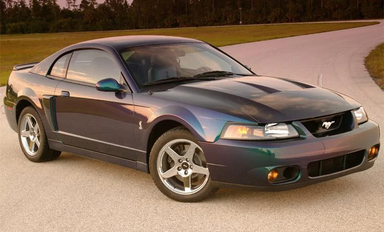

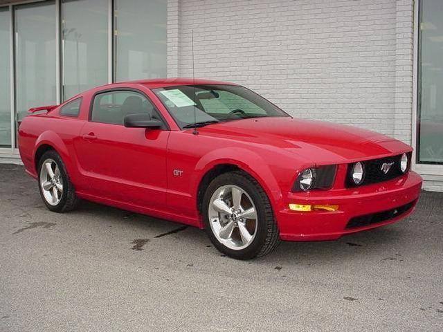

With less than an inch drop you are only level with stock Sti's and BRZ's. Hardly aesthetic. The S550 sits like a sedan from the factory.
Are you forgetting how high a new edge or S197 sat stock?
The S550 could certainly sit a tad lower, but its not an exaggerated height like the prior generations were. Not all of us are trying to win the stance off at vapecon 2017 going up against the subaru and toyobaru owners.
