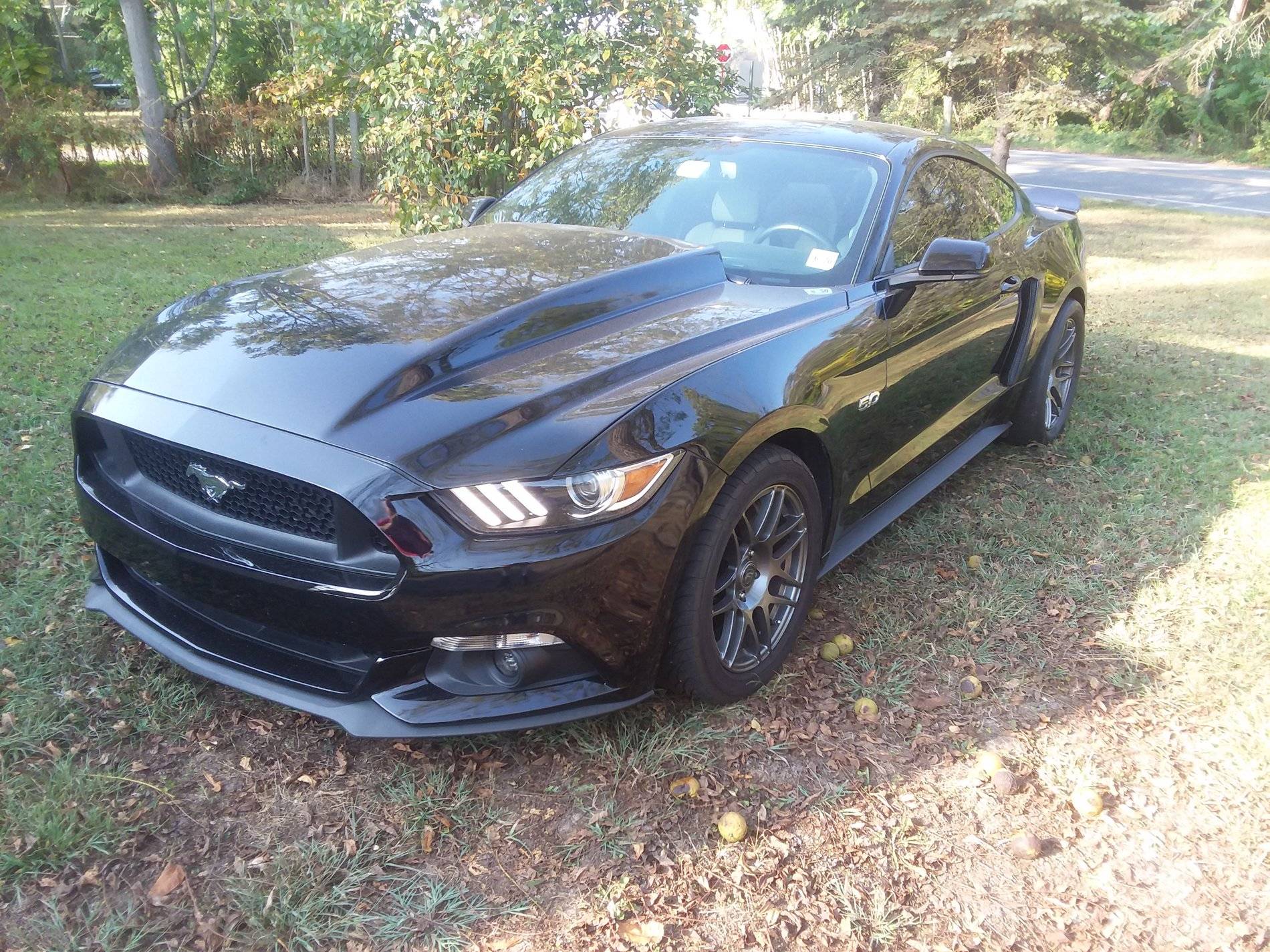

Looking at something like a 225/50-18 front (27") and 305/45-18 rear (29").
So it looks like a 2" delta may not be an issue.
Actually, those look like F14 wheels. That's exactly what I'm looking at, and it looks like you ran the same size rear I'm considering.
What were your wheel sizes, and what was the front tire size?

Wheels are 18x10.5 with a 305/45-r18 Nitto NTo5rs. And I run a 225 series tire up front on a 7 inch wheel.
I switched to a 325/35 mickeys out back because I didn’t like the ass in the air stance. The nitros were almost 29 inches tall. The mickeys are two inches less.
Got any other pictures of it with the previous setup? That's damn near what I was considering.
