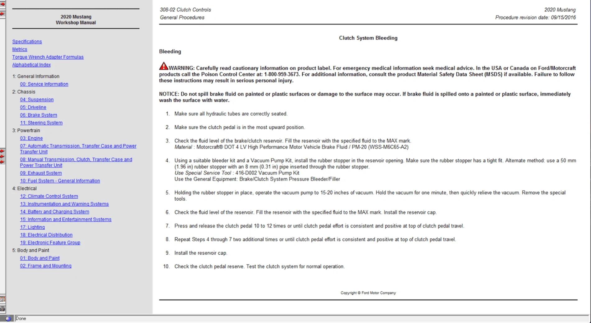

Don't think it is ment to be bench bled, that is for a MC .
Here is Fords how too
