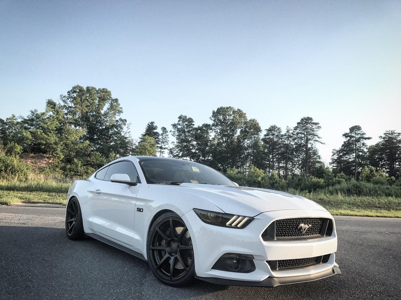

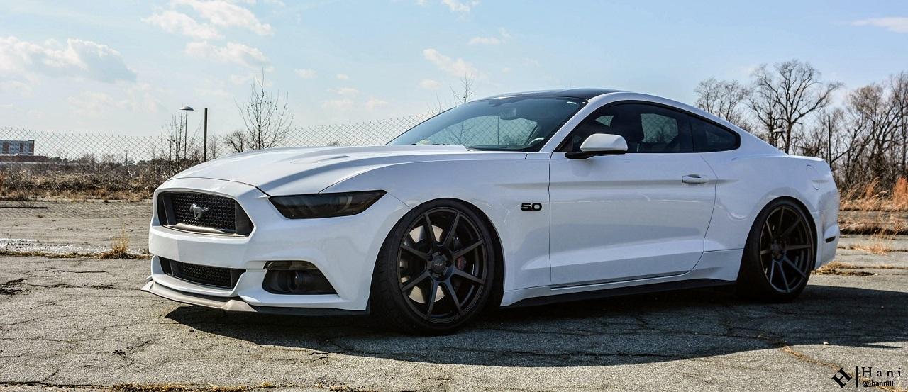

The top was when I was running them aggressively low up front. I moved them up since then.
