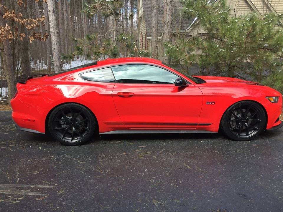

I had to use a 5mm spacer on the front to fit my m350 19X10 wheels with 275 Pirelli. Without the spacer they would rub slightly... just an fyi.
I have 275 with 20" wheels and have zero rubbing issues. I most likely have a different offset on the wheels than you.
