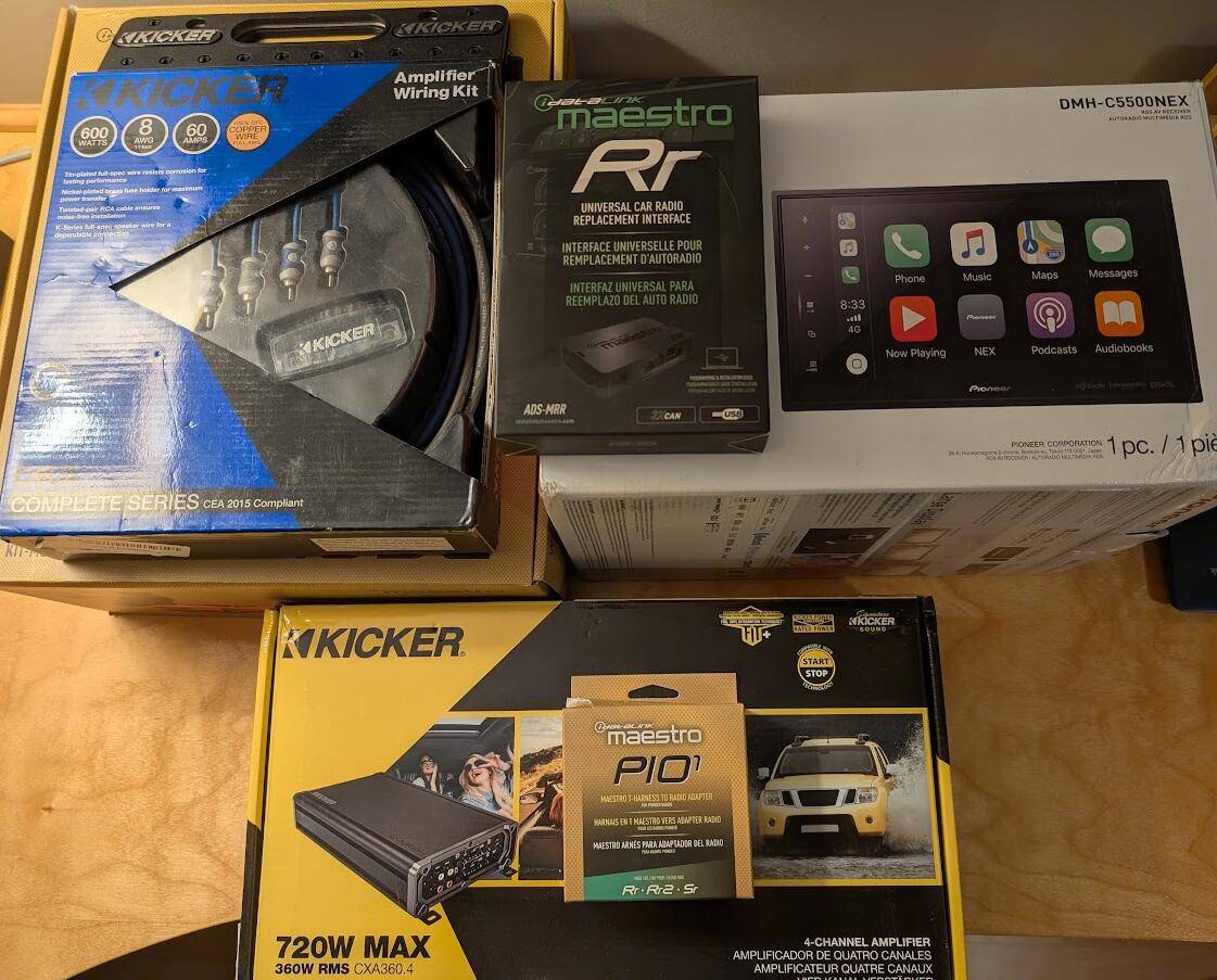

I've been slowly gathering components for an upgrade to my base 6-speaker stereo in a 2019 GT. I haven't settled on speaker replacements yet, but here is what I have so far. The box under the wiring kit is the bezel kit for the head unit. I plan on going with a powered subwoofer in the future.
Are there any items I still need to get, or have gotten that aren't necessary?

I would return all and get the Dynavin plus 4 ohm tweeters to start run all channels active.
From there you can add other speakers as they come up for sale used or new, and powered sub, sound deadening would be first on the list.
I think your current path will not deliver value or joy.

Unfortunately I can't return some of the more major components. Good reminder on the sound deadening. Will be sure to add some.
