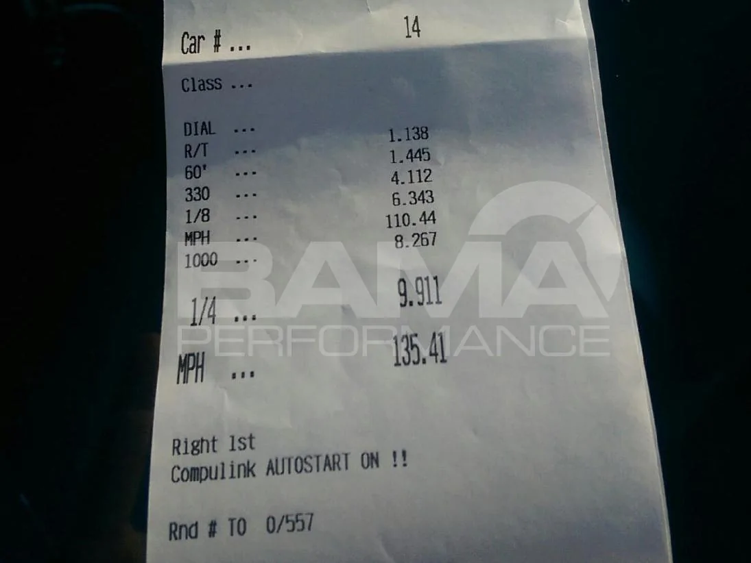

After their last record-breaking pass, the Bama Performance team went back to the track and just became the first sub-10 2015 Mustang GT, with a run of 9.91 @ 135 MPH!
With the addition of a 150 nitrous shot, FTW fuel, and a Boss intake manifold, the AmericanMuscle 2015 Mustang GT that Bama developed was able to bring home a 9 second slip from their second pass.

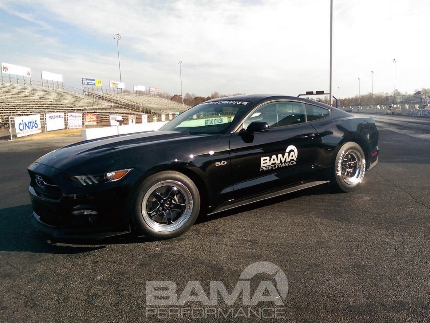

Here is the full list of modifications:
  • Full exhaust: custom 1-7/8” long tube headers, O/R X-pipe, race bullet mufflers
  • JLT Cold Air Intake
  • Boss Intake Manifold
  • Boost-A-Pump
  • Injector Dynamics ID1300 Injectors
  • Suspension Upgrades: custom fabricated
  • Weight Reduction to 3,450 lbs with half tank of fuel and driver (Removed passenger & rear seat)
  • Slicks and Skinnies: 17” Weld RTS with Mickey Thompson Front Runners and Hoosier Drag Slicks
  • DSS 1400 HP Axle Half-Shafts
  • DSS One-piece carbon-fiber driveshaft
  • 150 shot of Nitrous
  • Bama Performance X4 with Track Tune on FTW Fuel

Congrats!
In for sixty foot, and video!

Can you tell us more about the custom fabbed suspension parts you used? I can see you changed to V6 front brakes. What else did you do to lighten the front end and aid in weight shift?
AFAIK, the smaller brakes were swapped due to clearance issues with the factory Brembo calipers + Welds.
