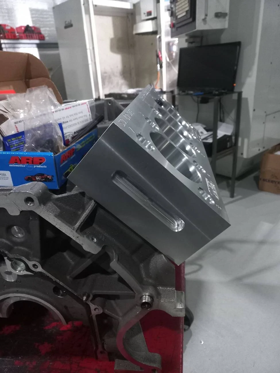

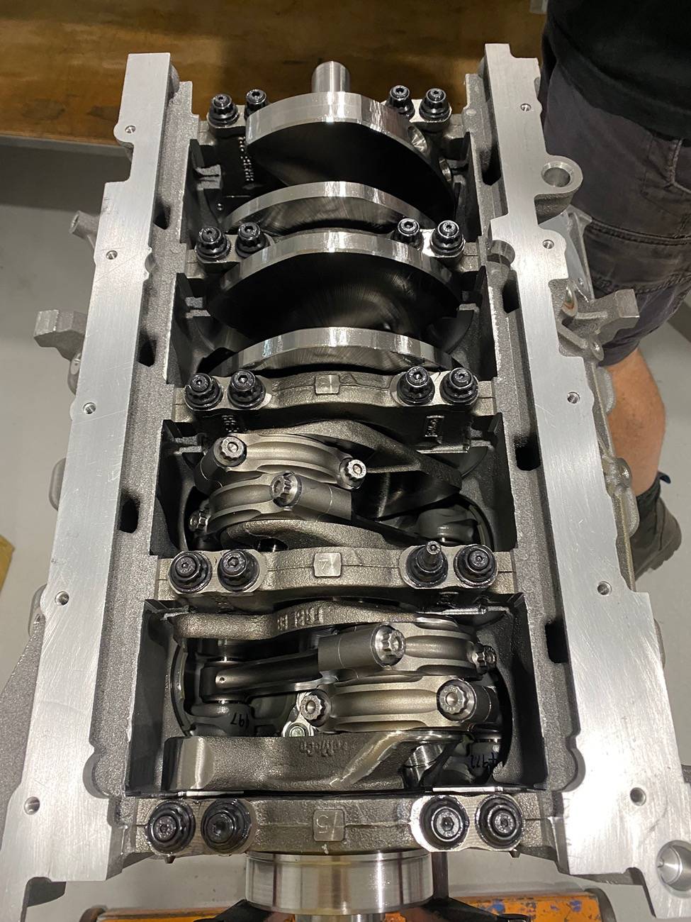

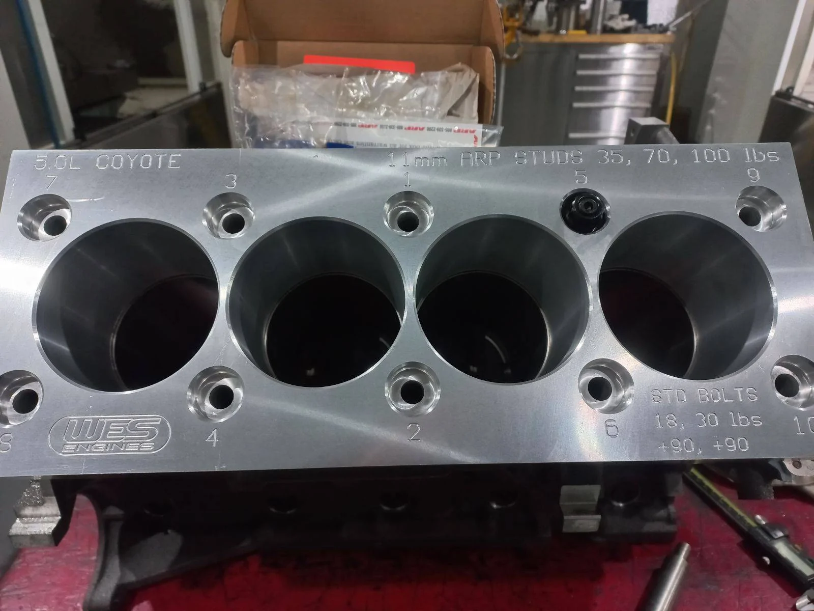

wow thats a very weird , and not sure how that’s possible with modern machines ??
for my engine its possible but not probable….
bottom end was sleeved and built by arguably one of the best and most pedantic engine builders in Australia ( a friend) , I also supplied aluminium block for a custom cnc machined torque plate
And as stated has no blowby or compression issues.

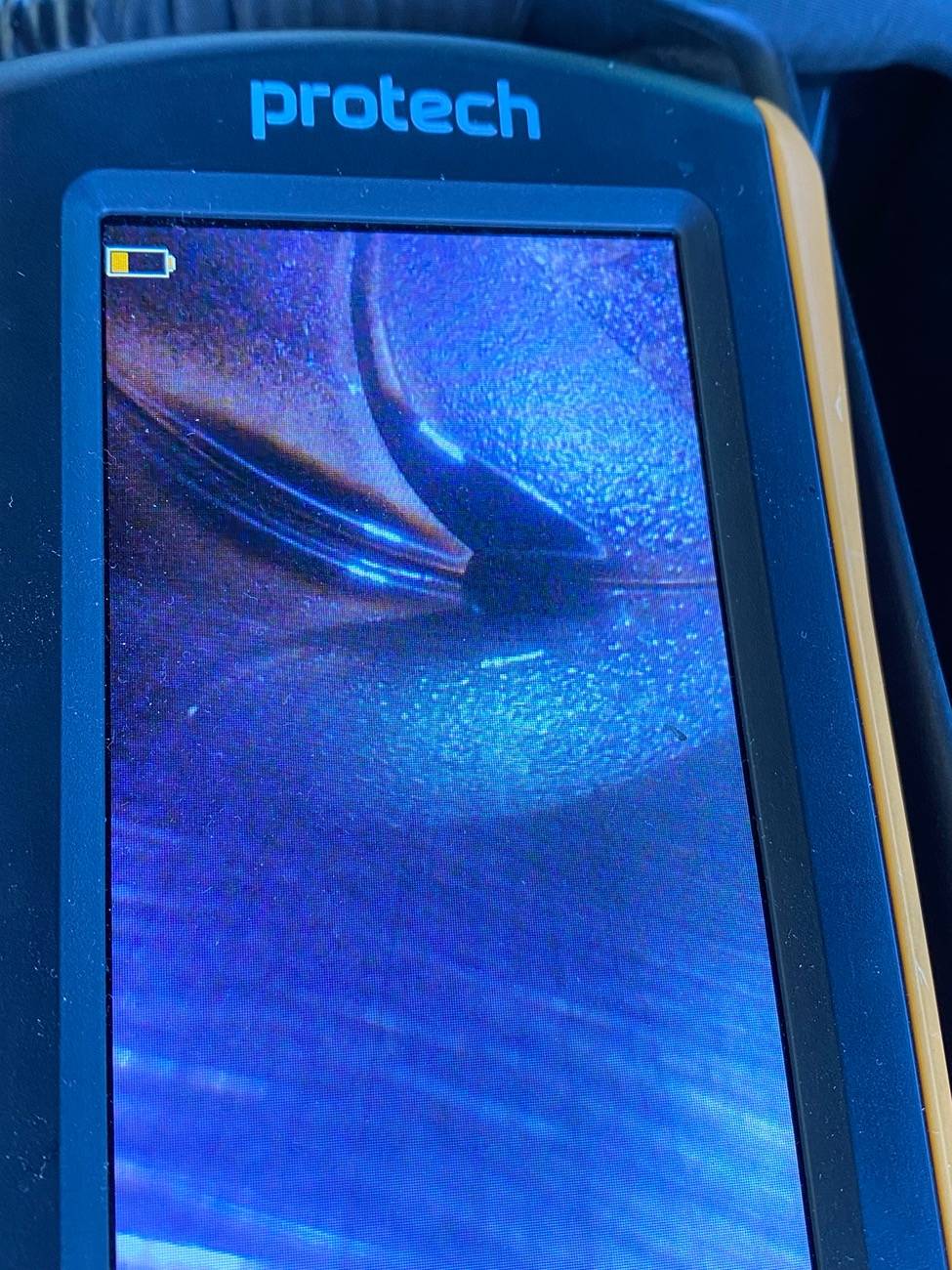

Further deep dive.
using a bore scope I tried to see if I could visually pick up any issues with the stem seal , like abnormal wear or marks on the valve stem but all looked good. But very hard to see.
so brought a new cylinder tester and all cylinders tested perfect 180psi , cold , dry , with no fuel as I pulled injector fuse.
So unfortunately I must of got a bad batch or some wrong size OEM valve seals.
