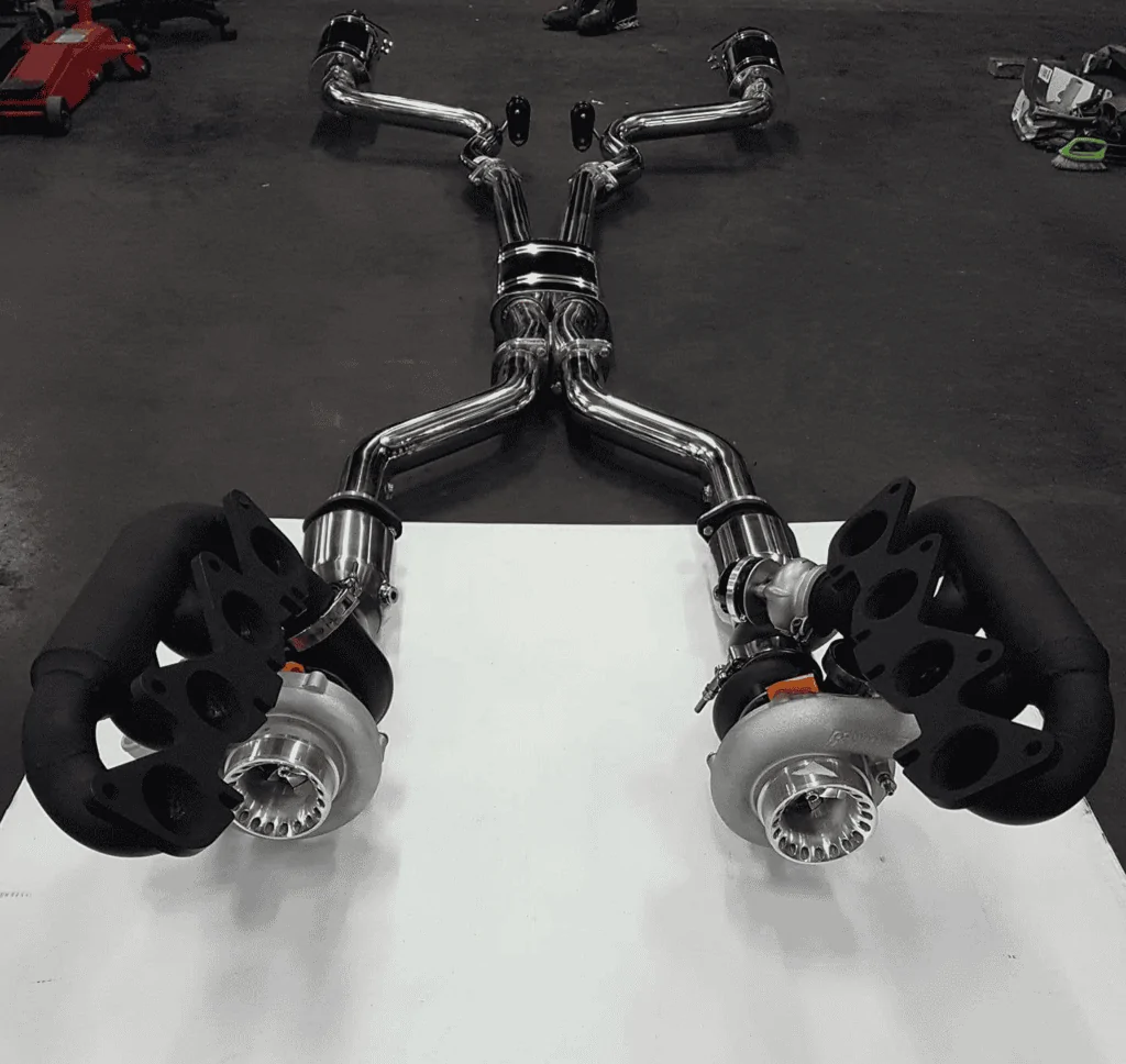

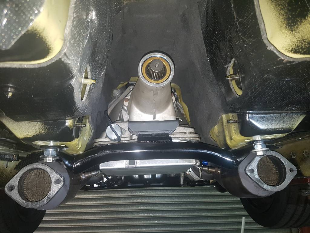

thought would throw this up, this is a mate's S550 being in Australia we are right hand drive so nothing in the US fits, he has done all the turbo setup etc himself, tuned it (540rwhp/6psi on our 98-octane is equivalent to US 91octane, MT82), not bad for a 23yo kid. the MT82 was dropped in favour of a 'Glide, we are just gonna go out have a few hits on the stock motor, see what it can do, then put the MT82 back in.

Are those custom manifolds ?
Subscribing for results .

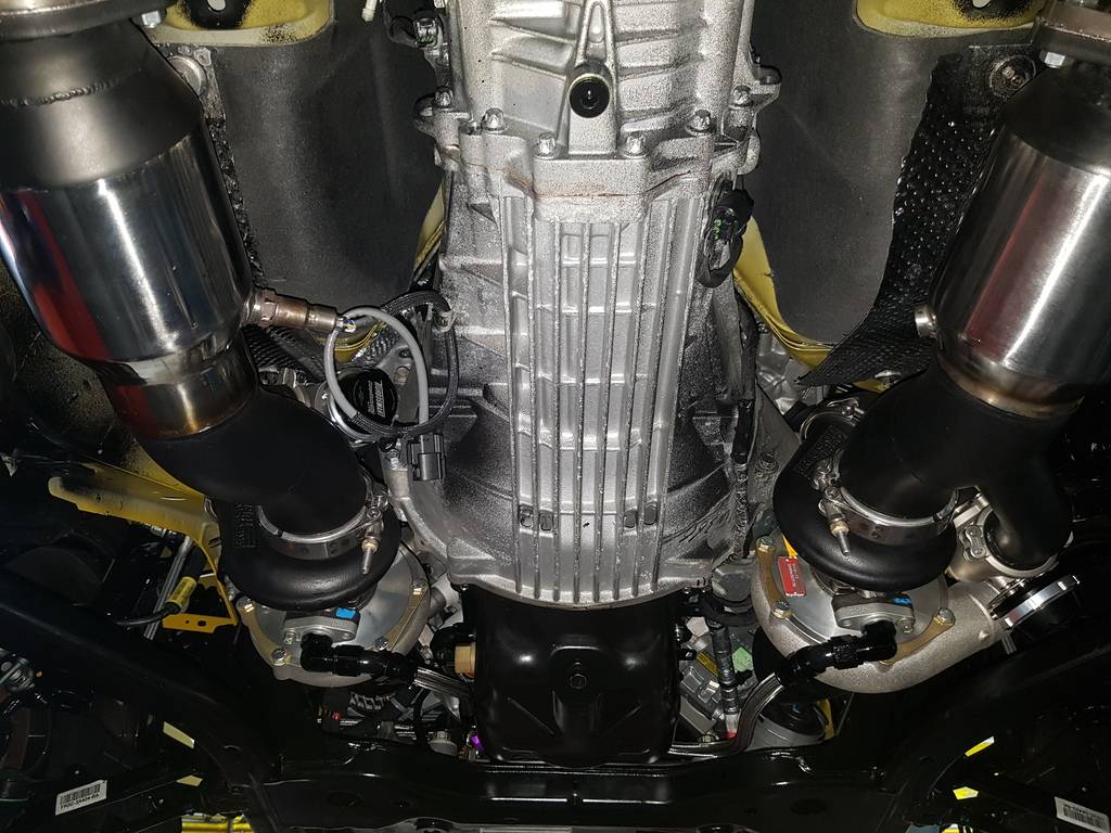

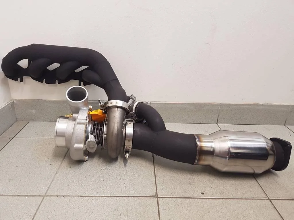

yeah they are a custom manifold, being a right hand drive car, nothing made for the US etc Mustangs will fit. was a long process, was started in Feb, was mainly done in what free time was available, has been driving around the last 2 months or so, till went in for the 'Glide, was a long wait for the driveshaft to be made. all the fab work apart from the intercooler itself was done by Nick (car owner) we had done a few low mount LS Holden Commodores (Aussie Chevy SS/Pontiac G8) over the last 10 years, and they worked well so we figured would try it on the Mustang, had only seen the Hellion kit prior. it's 1-3/4 primaries, we tried to have a bit of length on them going into the log but it's pretty tight there :p we have Precision 6062's on it with V-Band .82 rear, it's quite responsive if need be we can get 6-7psi by 2700rpm, however we have adjusted the cams to have the power coming in a little slower by 3000-3200rpm
