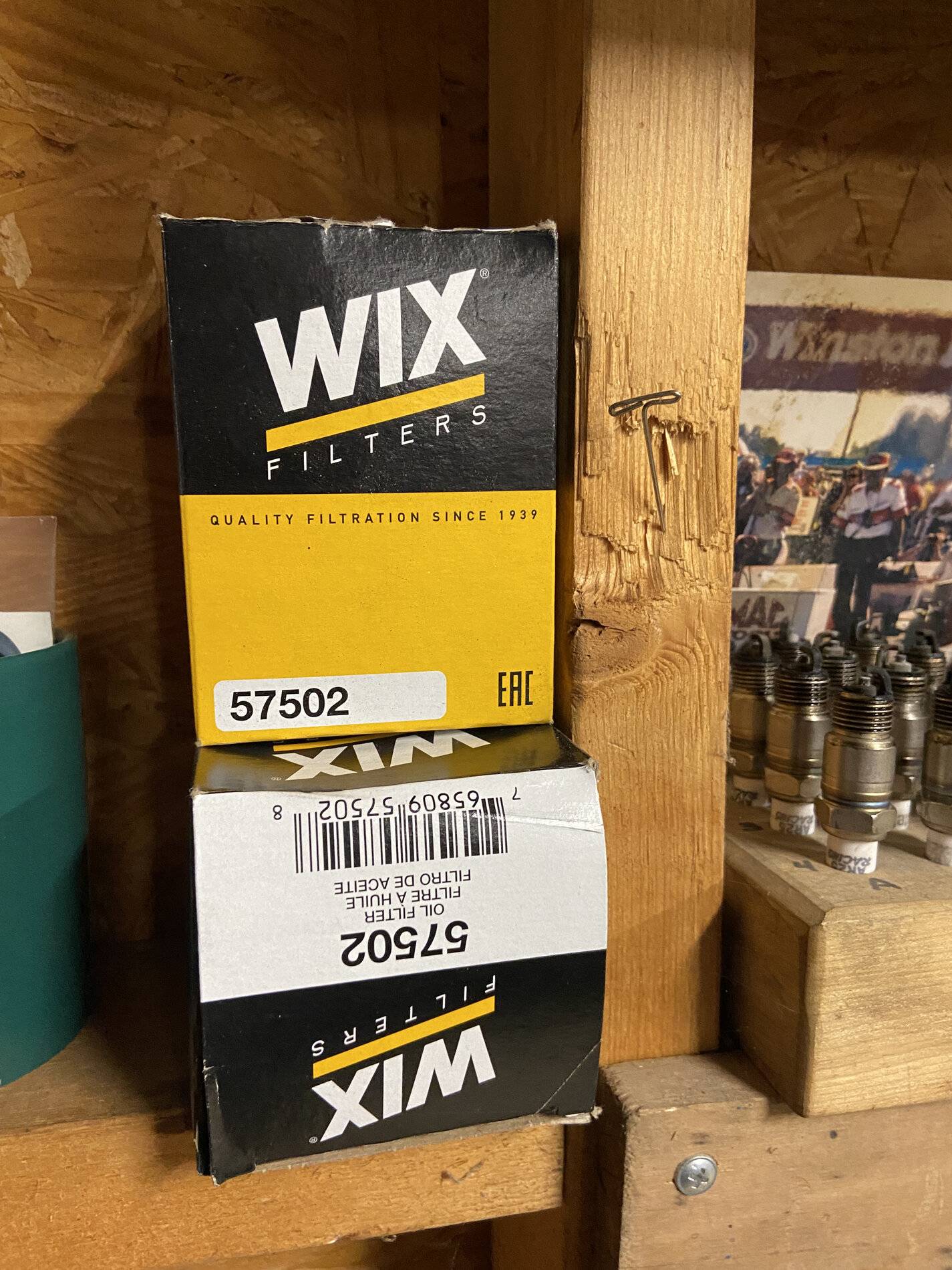

Looks to be a longer version of an 820. Looks like it will hold a full Qt of oil.

Ford > WIX direct replacement, cross over.

Decided to try the Baldwin B281.

I threw a Napa Gold 7502 for the most recent change. Made a heck of a rookie mess taking the old one off too. Jeez.
if you mean getting oil all over the large wiring harness, and the rest.
Here is a trick I read on the forum, use tin foil to cover the area. Tin foil works best because you can mash it around stuff and it stays.
Seeing the situation, the first time I used a plastic bag, sort of worked, tin foil better stays in place.
WIX 57502 is same filter as the NAPA, that gold paint not worth the extra $$
