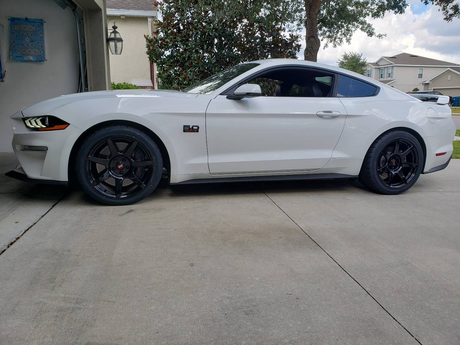

I'm running SVE 350R 10" wheels up front with 285/35/19's. Rears are 305's. No Poke or spacers...plug and play. Pick of fronts, the wheels are slightly turned.
