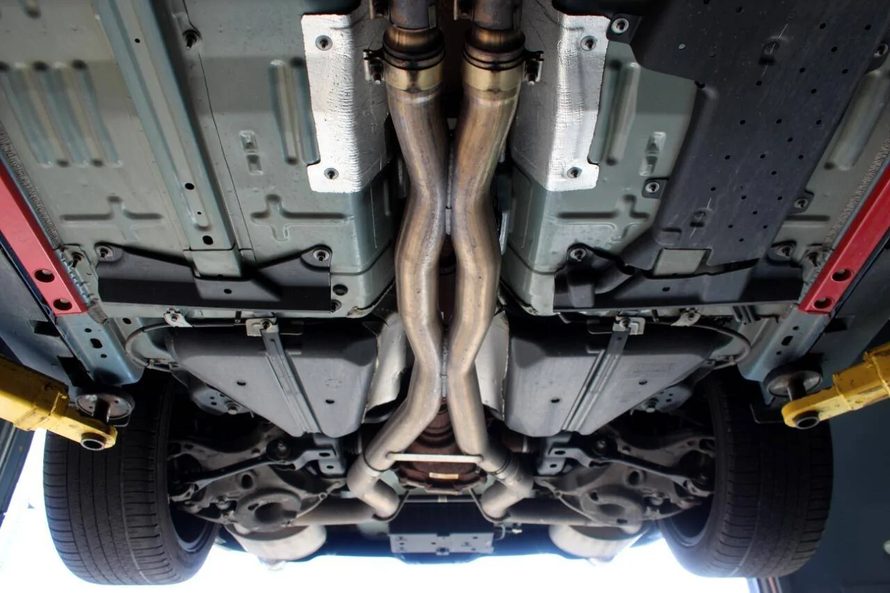

I picked up my Mustang two weeks ago and it was stock except for a Corsa catback. I've checked for stamping on it and the Corsa lady told me she isn't aware of any identifying marks on the piping.
The mod bug quickly bit me in the ass and I'm purchasing the rest of my bolt ons now, but I don't want to keep the Corsa exhaust and pair it with long tubes if it's the extreme system. I posted a pic under the car and a (warm) start video if any can tell by those.

I have the extreme. That sounds more like sport to me. Hard to tell being under the car wash though. It’s also easier to compare cold starts. The sport sounds more ’muffled’.

Yup, shine the light in the exhaust, if the straight piece is solid it’s the Xtremes, if the straight piece has small perforated holes it’s the touring/sport.

Thanks guys, based on the video and flashlight method I think it's the sports. Either way, my neighbors will just have to deal with the long tubes I guess.
