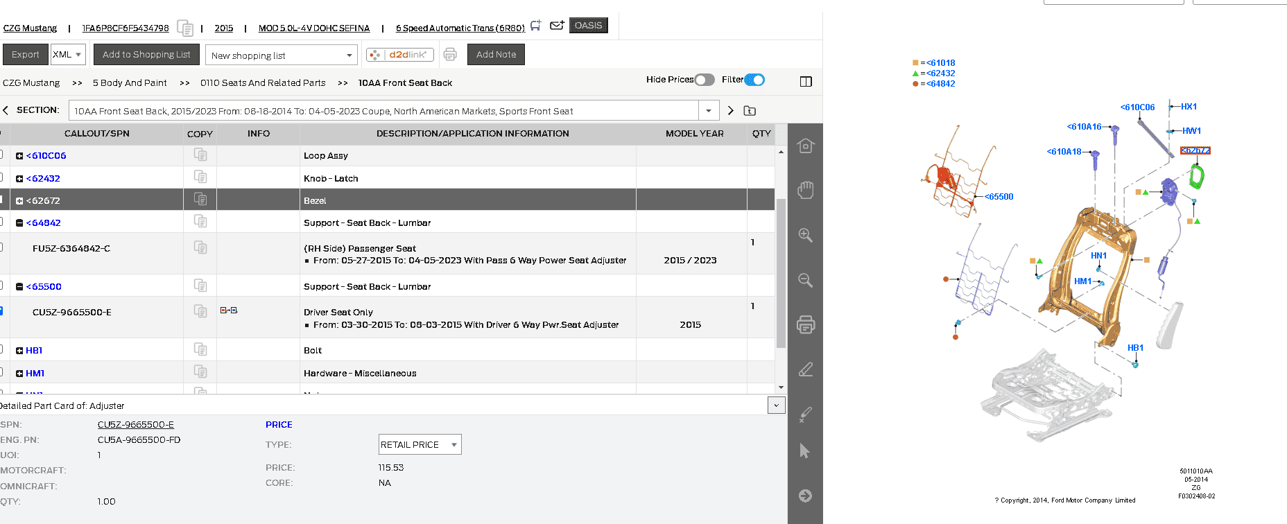

Possible part # CU5Z-9665500-E
$ 115.53 retail
