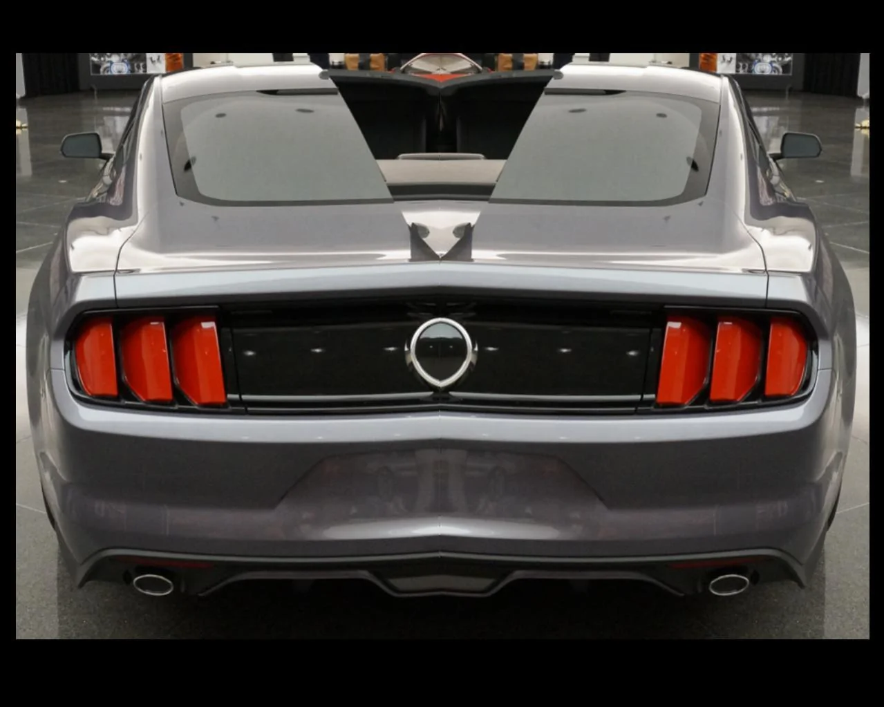

What the Designers intended - sort of
Clay model shows what should have been built, although the trunk is just so slightly down, based on the lower reflections in the Black Plastic. Notice once again, the fenders are designed wider than the bumper.
At least in this photo, the trunk lid lip is the same height as the fender around the top of the tail lights. Not so on production vehicles. Big dark gap. Very noticeable.
I reversed one side of the photo to make it more normal-looking and eliminate the left side of the car which was the convertible half.
