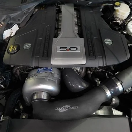

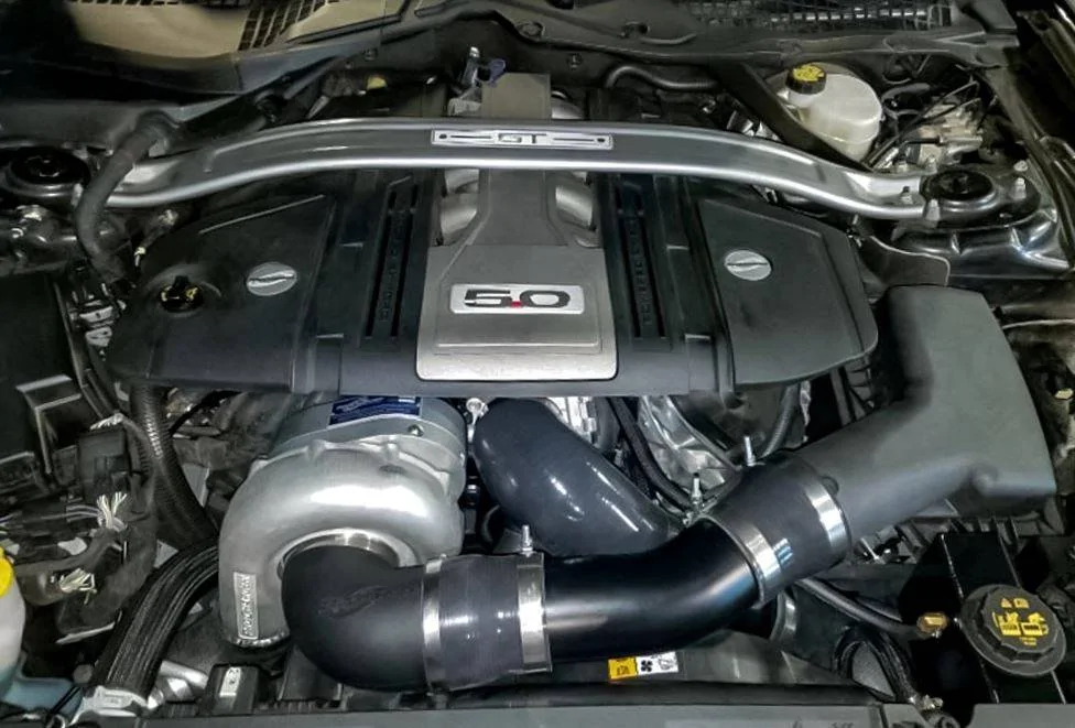

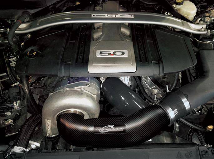

Does it come with a carbon fiber elbow or black? some photos in the instructions show a carbon one while I see a black one and a hyrbid shorter one?

Comes with a Carbon one. I really need to go take better photos, I just been slammed and forgot all about it!
