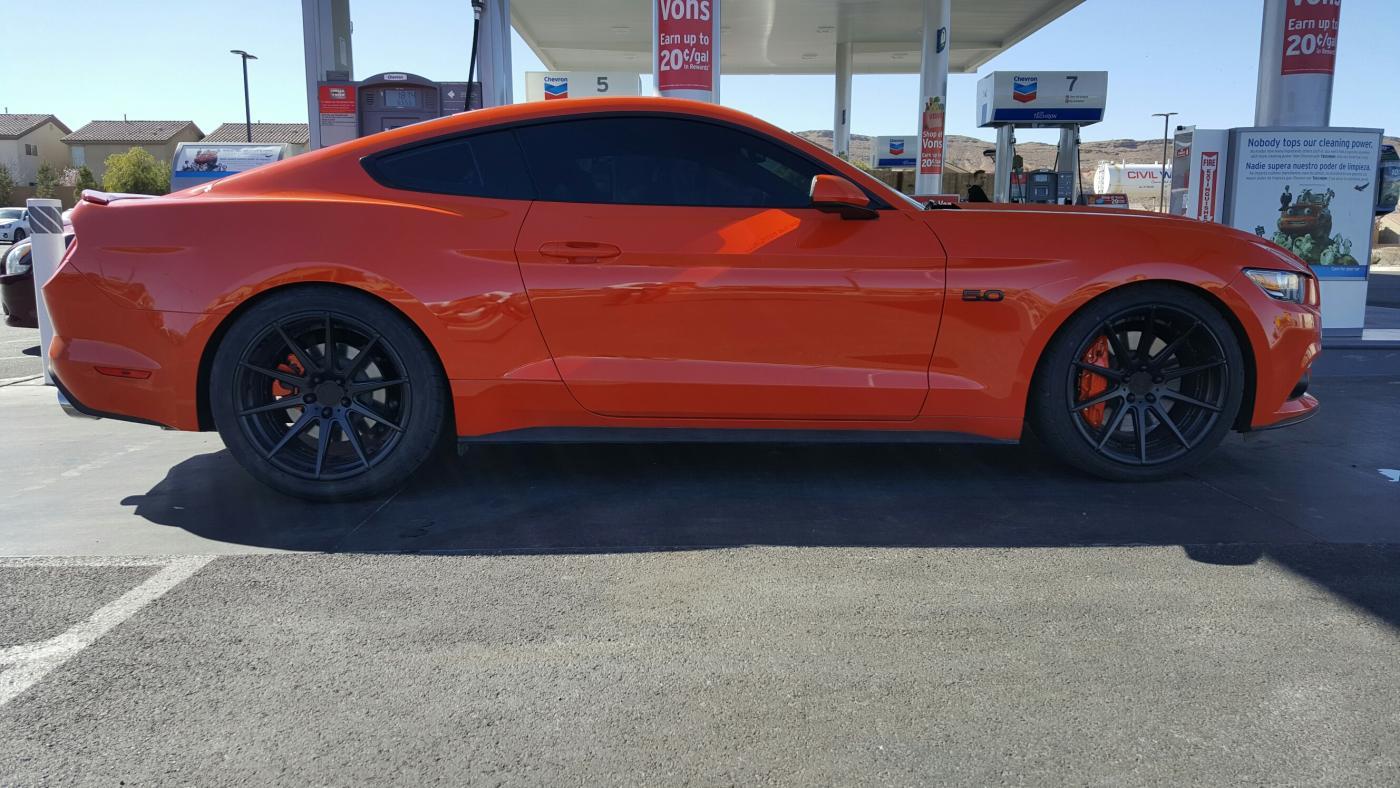

My friend and I just did my fronts a couple of weeks ago. We used a brush for the first coat and a preval sprayer for the rest. The preval was a God send. It made short work of the last three coats and really came out nicely. I finally recieved my new Brembo stickers, so the pic is just the freshly painted caliper.
We took the time to sand down the front face of the caliper before painting. We also knocked down the casting lines for a smoother appearance. I will be flat blacking the rears since they aren't much to look at anyway.
