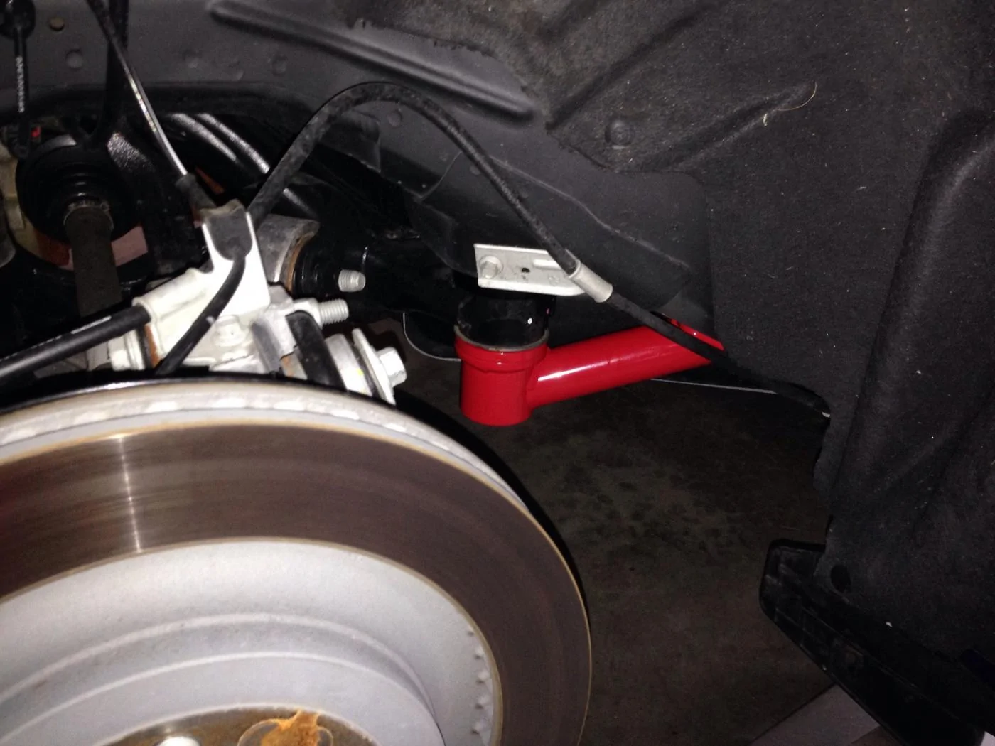

BMR jacking rails = done
BMR cradle lockout = done
BMR vertical links = done
BMR toe rods = done
FR half shafts = done
And I squeezed in a dawg house build in between gaming sessions :cheers:

I did my own alignment with string, and finally went to a precision alignment shop that specializes in race cars and aftermarket suspension to check it - rear alignment was perfect :clap2: I'll start pushing it even harder now - but my initial impressions are the rear end feels much tighter and wheel hop is about 95% gone. I spun 2nd gear hard messing around with my buddies Viper and it hopped a bit - but my tires were cold and the pavement was a bit uneven and kinda tore up. Any other launches I tried so far or 2nd gear "boost slides" were rock solid with zero hop. BTW - this testing was done on stock springs, shocks, and tires as well as stock PP sways and end links.
Jacking rails are simply awesome for me - much more convenient when putting the car on stands or ramps
